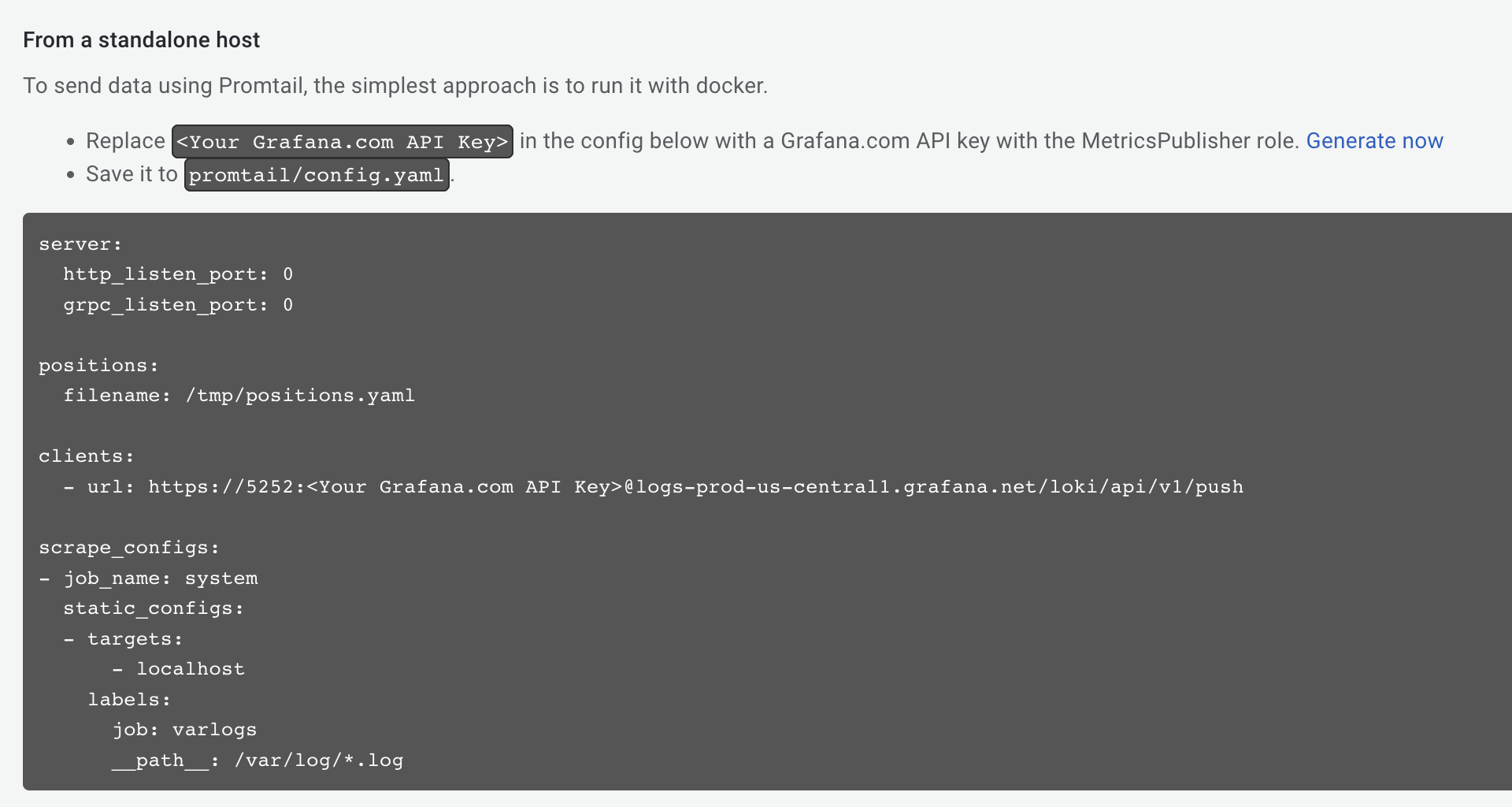

Grafana Loki is a horizontally scalable, highly available, multi-tenant log aggregation system inspired by Prometheus. Similar to Prometheus, to send from OTLP to Loki, we will do a passthrough from the otelcol.exporter.loki component to loki.write component.
otelcol.exporter.loki "default" {
forward_to = [loki.write.default.receiver]
loki.write "default" {
endpoint {
url = "http://loki-endpoint:8080/loki/api/v1/push"
}To use Loki with basic-auth, which is required with GrafanaCloud Loki, you must configure the loki.write component. You can get the Loki config from the Loki Details page in the GrafanaCloud Portal:
otelcol.exporter.loki "grafana_cloud_loki" {
forward_to = [loki.write.grafana_cloud_loki.receiver]
loki.write "grafana_cloud_loki" {
endpoint {
url = "https://logs-prod-us-central1.grafana.net/loki/api/v1/push"
basic_auth {
username = 5252
password = env("GRAFANA_CLOUD_API_KEY")

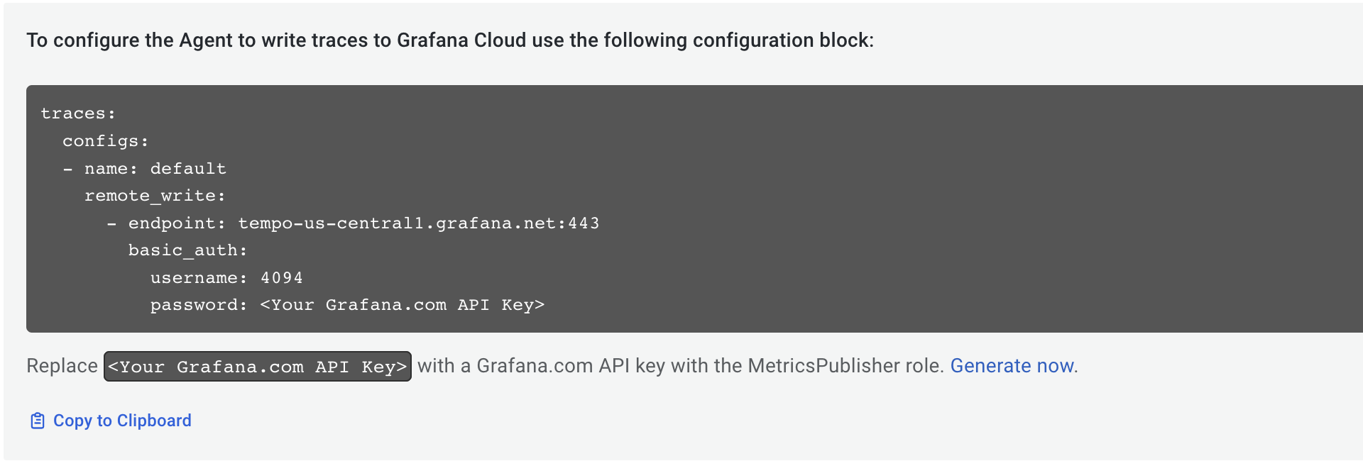

}Grafana Tempo
Grafana Tempo is an open-source, easy-to-use, scalable distributed tracing backend. Tempo can ingest OTLP directly, and you can use the OTLP exporter to send the traces to Tempo.
otelcol.exporter.otlp "default" {
client {
endpoint = "tempo-server:4317"
}To use Tempo with basic-auth, which is required with GrafanaCloud Tempo, you must use the otelcol.auth.basic component. You can get the Tempo config from the Tempo Details page in the GrafanaCloud Portal:
otelcol.exporter.otlp "grafana_cloud_tempo" {
client {
endpoint = "tempo-us-central1.grafana.net:443"
auth = otelcol.auth.basic.grafana_cloud_tempo.handler
otelcol.auth.basic "grafana_cloud_tempo" {
username = 4094

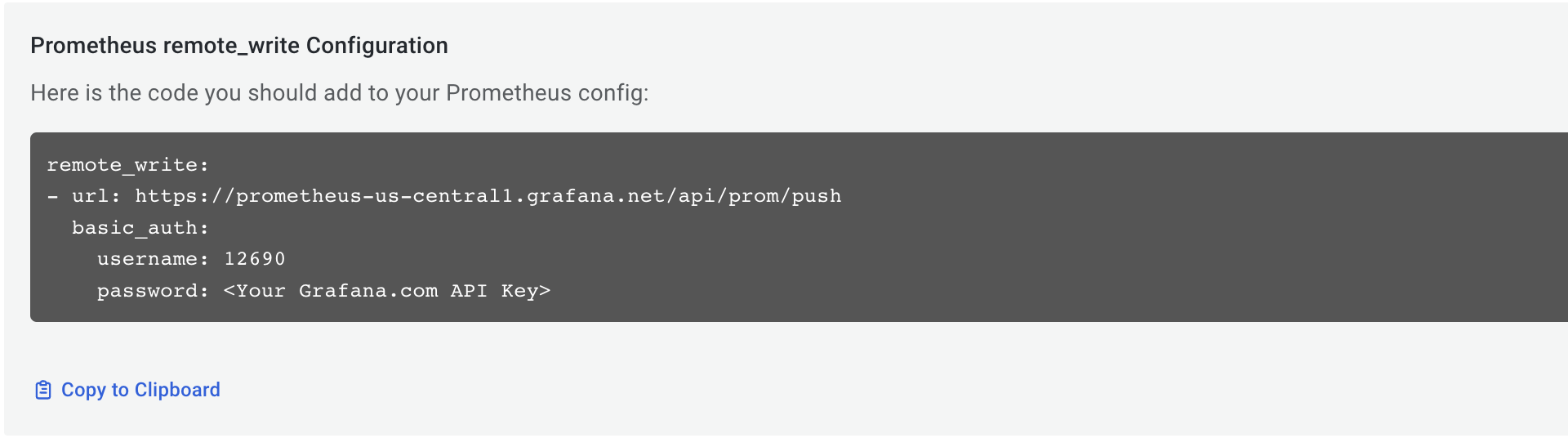

}Grafana Mimir or Prometheus Remote Write
Prometheus Remote Write is a popular metrics transmission protocol supported by most metrics systems, including Grafana Mimir and GrafanaCloud. To send from OTLP to Prometheus, we do a passthrough from the otelcol.exporter.prometheus to the prometheus.remote_write component. The Prometheus remote write component in Agent is a robust protocol implementation, including a Write Ahead Log for resiliency.
otelcol.exporter.prometheus "default" {
forward_to = [prometheus.remote_write.default.receiver]
prometheus.remote_write "default" {
endpoint {
url = "http://prometheus:9090/api/v1/write"
}To use Prometheus with basic-auth, which is required with GrafanaCloud Prometheus, you have to configure the prometheus.remote_write component. You can get the Prometheus config from the Prometheus Details page in the GrafanaCloud Portal:
otelcol.exporter.prometheus "grafana_cloud_prometheus" {
forward_to = [prometheus.remote_write.grafana_cloud_prometheus.receiver]
prometheus.remote_write "grafana_cloud_prometheus" {
endpoint {
url = "https://prometheus-us-central1.grafana.net/api/prom/push"
basic_auth {
username = 12690

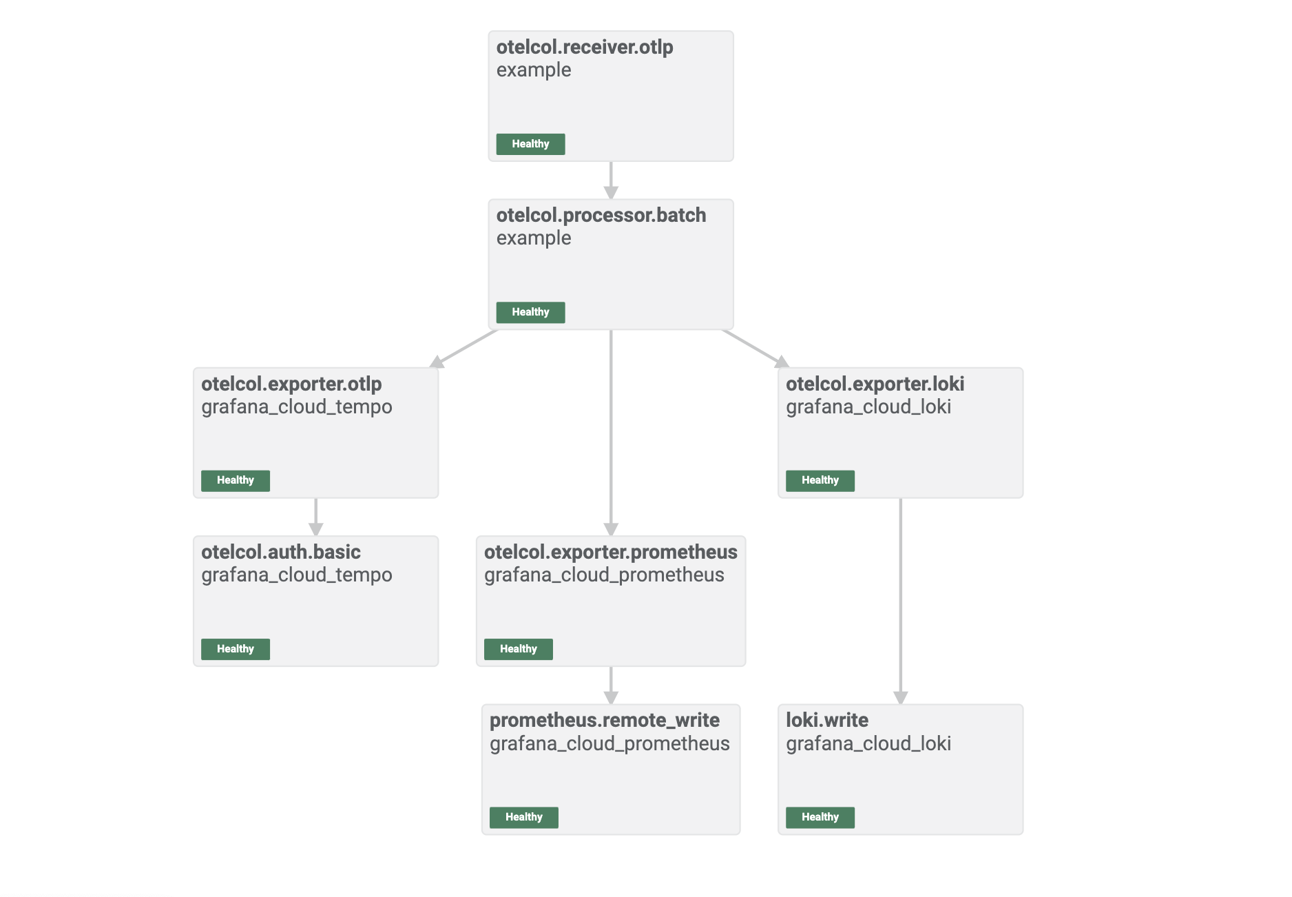

}Putting it all together
Instead of referencing otelcol.exporter.otlp.default.input in the output of otelcol.processor.batch, we need to reference the three exporters we set up. The final configuration becomes:
otelcol.receiver.otlp "example" {
grpc {
endpoint = "127.0.0.1:4317"
http {
endpoint = "127.0.0.1:4318"
output {
metrics = [otelcol.processor.batch.example.input]
logs = [otelcol.processor.batch.example.input]
traces = [otelcol.processor.batch.example.input]
otelcol.processor.batch "example" {
output {
metrics = [otelcol.exporter.prometheus.grafana_cloud_prometheus.input]
logs = [otelcol.exporter.loki.grafana_cloud_loki.input]
traces = [otelcol.exporter.otlp.grafana_cloud_tempo.input]
client {
username = 4094
endpoint {
basic_auth {
username = 12690
endpoint {
basic_auth {
username = 5252
}Running the Agent now will give you the following:
