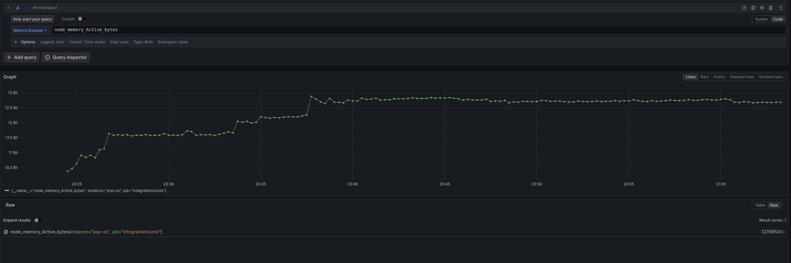

/path/to/agent run config.riverNavigate to http://localhost:3000/explore in your browser. After ~15-20 seconds, you should be able to see the metrics from the prometheus.exporter.unix component! Try querying for node_memory_Active_bytes to see the active memory of your host.
