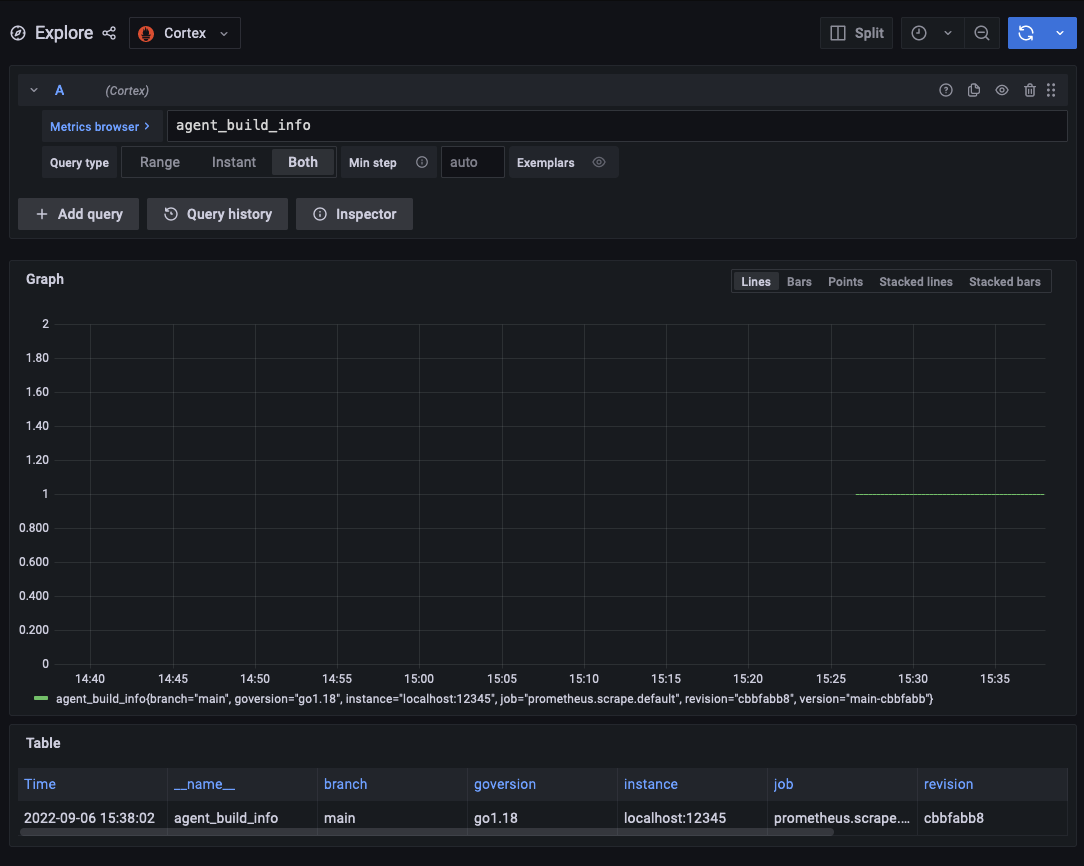

Allow Grafana Agent to run for two minutes, then navigate to Grafana.
This example scrapes the Grafana Agent Flow http://localhost:12345/metrics endpoint and pushes those metrics to the Mimir instance.

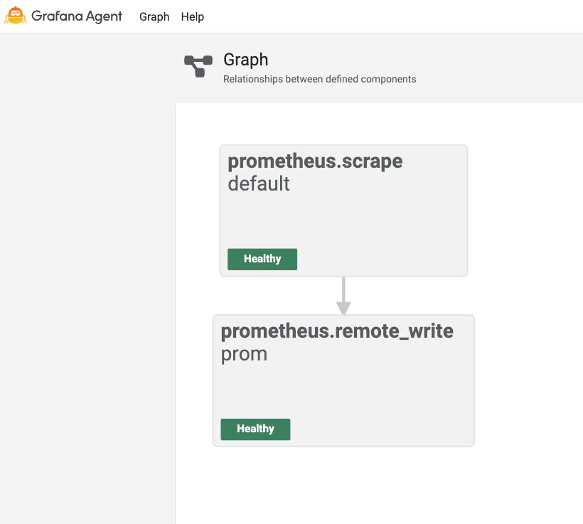

Navigate to http://localhost:12345/graph to view the Grafana Agent Flow UI.

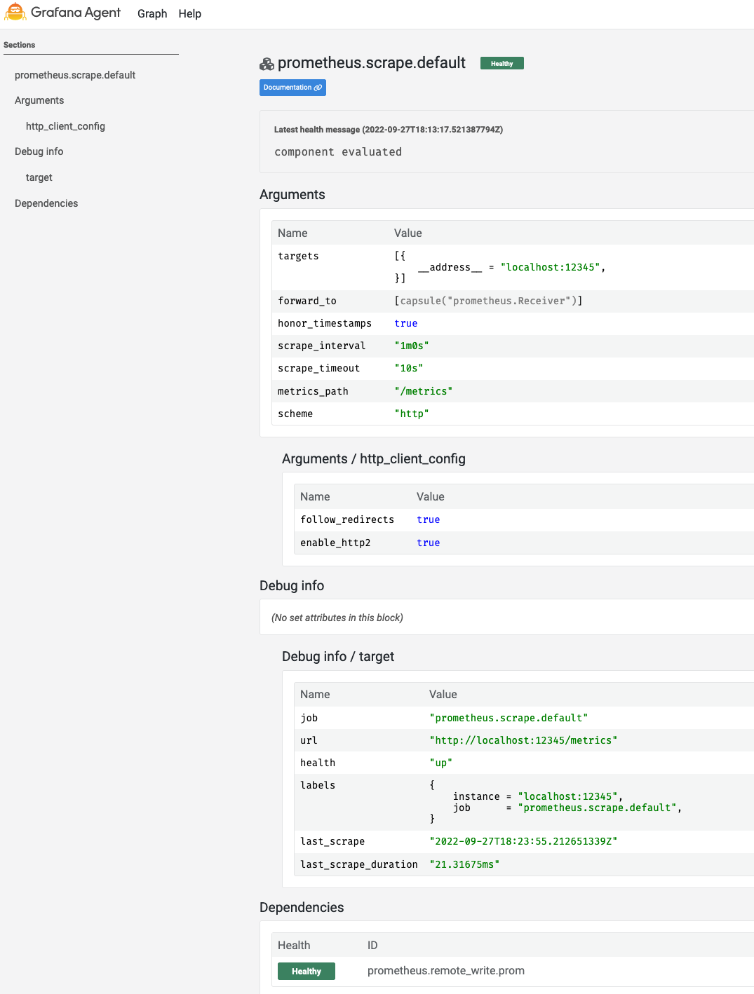

Grafana Agent displays the component pipeline in a dependency graph. See Scraping component and Remote Write component for details about the components used in this configuration. Click the nodes to navigate to the associated component page. There, you can view the state, health information, and, if applicable, the debug information.

}The prometheus.scrape "default" annotation indicates the name of the component, prometheus.scrape, and its label, default. All components must have a unique combination of name and if applicable label.
The targets
attribute is an
argument. targets is a list of labels that specify the target via the special key __address__. The scraper is targeting the Grafana Agent Flow /metrics endpoint. Both http and /metrics are implied but can be overridden.
The forward_to attribute is an argument that references the
export of the prometheus.remote_write.prom component. This is where the scraper will send the metrics for further processing.
