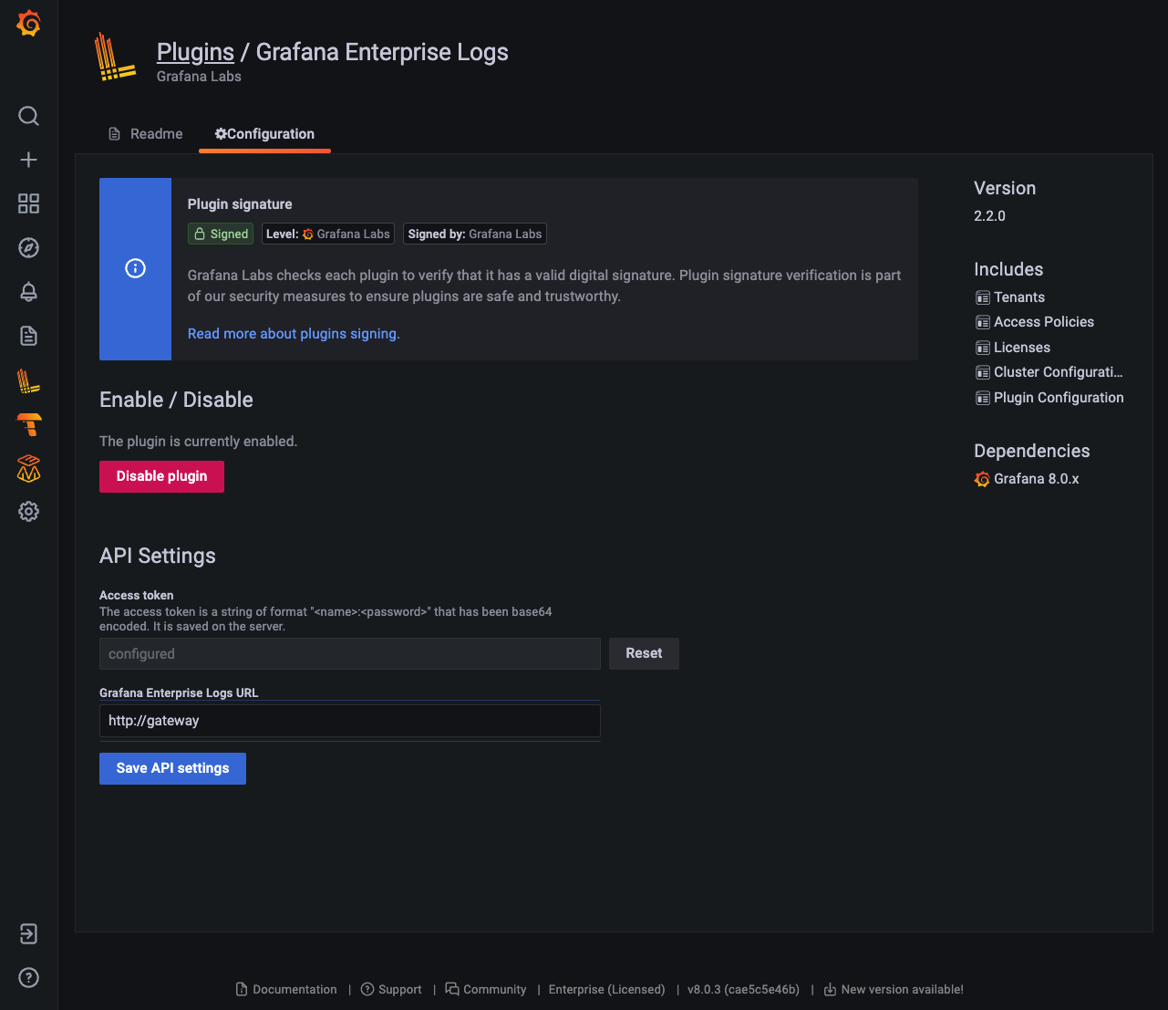

Enable and configure the plugin
Log in to your Grafana Enterprise Logs.
Go to the Config/Plugins page and select the Grafana Enterprise Logs (GEL) plugin from list.
From the configuration page of the plugin, enable the plugin by clicking on the “Enable plugin” button.
Provide the necessary API settings so that the plugin can connect to your cluster:
- Access Token: Enter the admin-scoped access token that you generated when setting up your GEL cluster.
- Grafana Enterprise Logs URL: Enter the URL of your GEL cluster. For single-process clusters, this is any node in the cluster. For microservice deployments, the URL is the GEL gateway. If you followed the Deploy on Kubernetes guide, your URL is
http://ge-logs.<namespace>.svc.cluster.local:8100/, where<namespace>is the namespace that you used. For example, if you used the default namespace, then your URL would behttp://ge-logs.default.svc.cluster.local:8100/.![Configuration GEL plugin page Configuration GEL plugin page]()
Click Save API settings.
Verify that the plugin loads and can communicate with the GEL admin API endpoints.
Navigate to the GEL plugin through the main menu to see the default access policy under the Access Policies tab.
