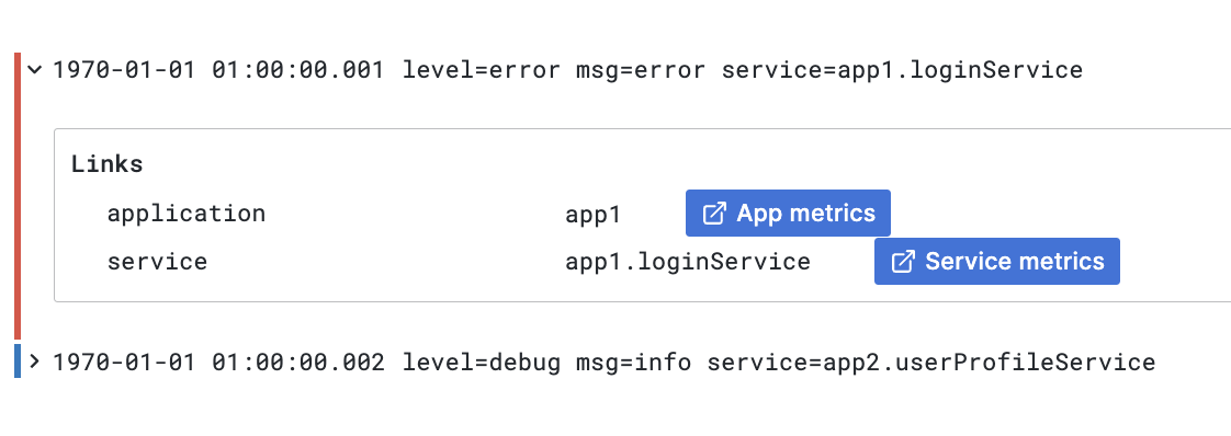

[ { "meta": { "preferredVisualisationType": "logs" }, "fields": [ { "name": "time", "values": [1, 2] }, { "name": "msg", "values": [ "level=error msg=error service=app1.loginService", "level=debug msg=info service=app2.userProfileService" ] } ] } ]Run the query and open log details by clicking on the log line.
![Correlation links in Logs panel Correlation links in Logs panel]()
Correlation links in Logs panel A link “App metrics” and “Service metrics” show next to variables extracted out of the log line with transformations
Click on the “App metrics” link.

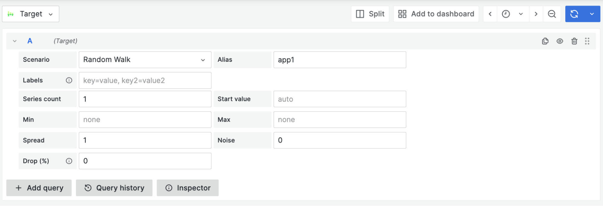

A split view is opened and the target query is run.
Notice how the application name from the log line is filled in as the alias property in the target query.
![Interpolated target query Interpolated target query]()

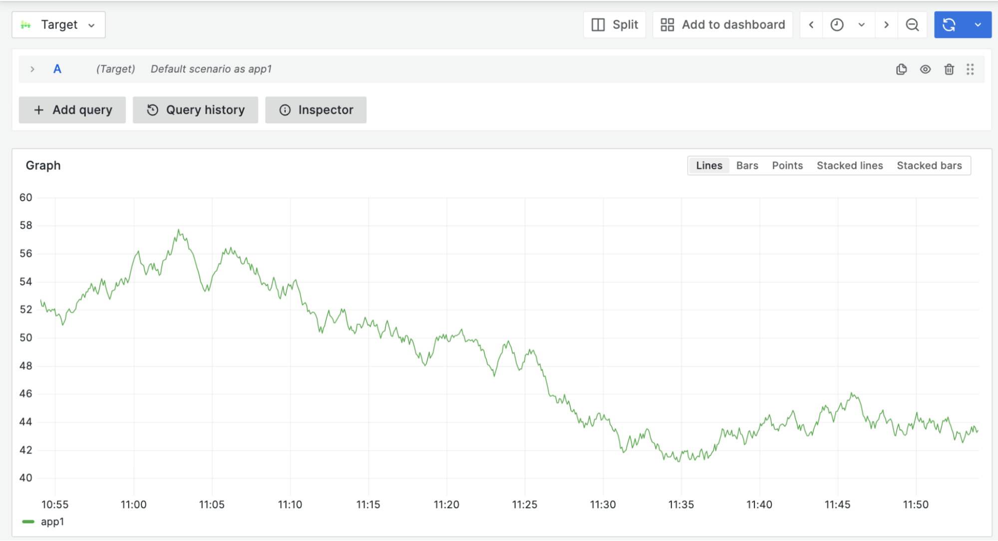

Interpolated target query This allows you to run a specific query based on the source results:
![Interpolated target query results Interpolated target query results]()

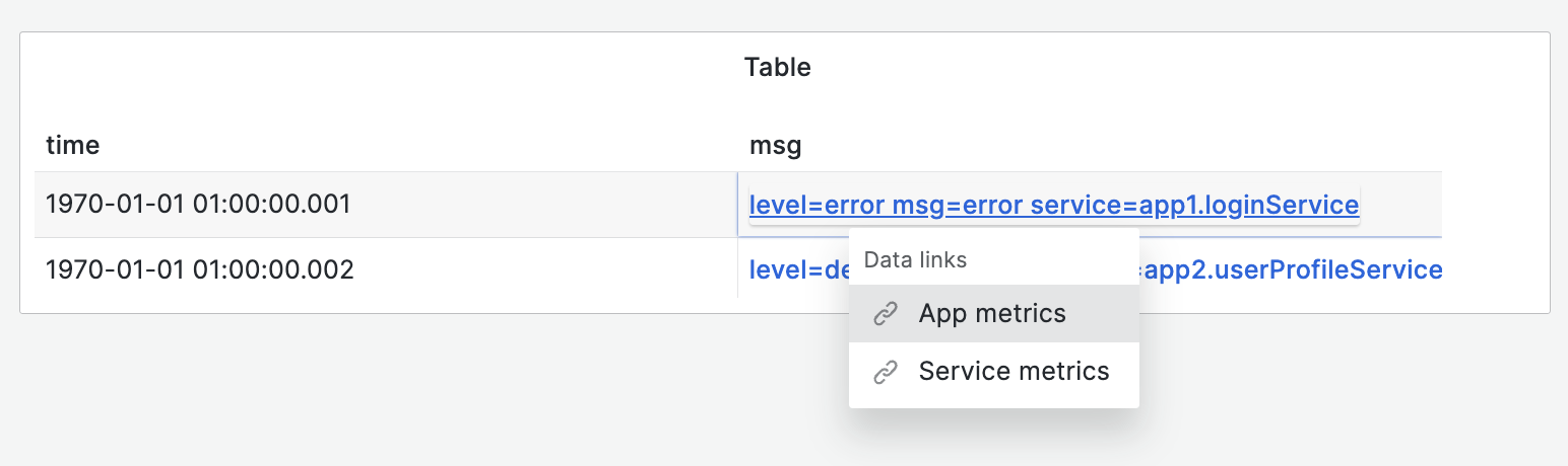

Interpolated target query results Go back to the source query and change raw frames’ preferred visualization type to “table” to see how links are displayed in a Table visualization.
[ { "meta": { "preferredVisualisationType": "table" }, "fields": [...] } ]Run the query and notice how links are created in the Table cell:
![Correlations links in table Correlations links in table]()
