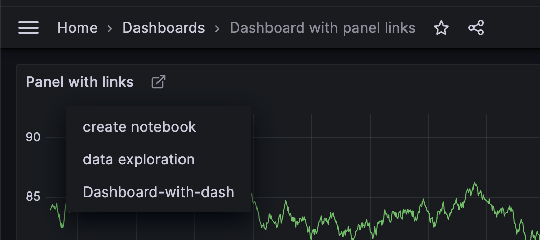

Panel links
Each panel can have its own set of links that are shown in the upper left of the panel after the panel title. You can link to any available URL, including dashboards, panels, or external sites. You can even control the time range to ensure the user is zoomed in on the right data in Grafana.
Click the icon next to the panel title to see available panel links.
