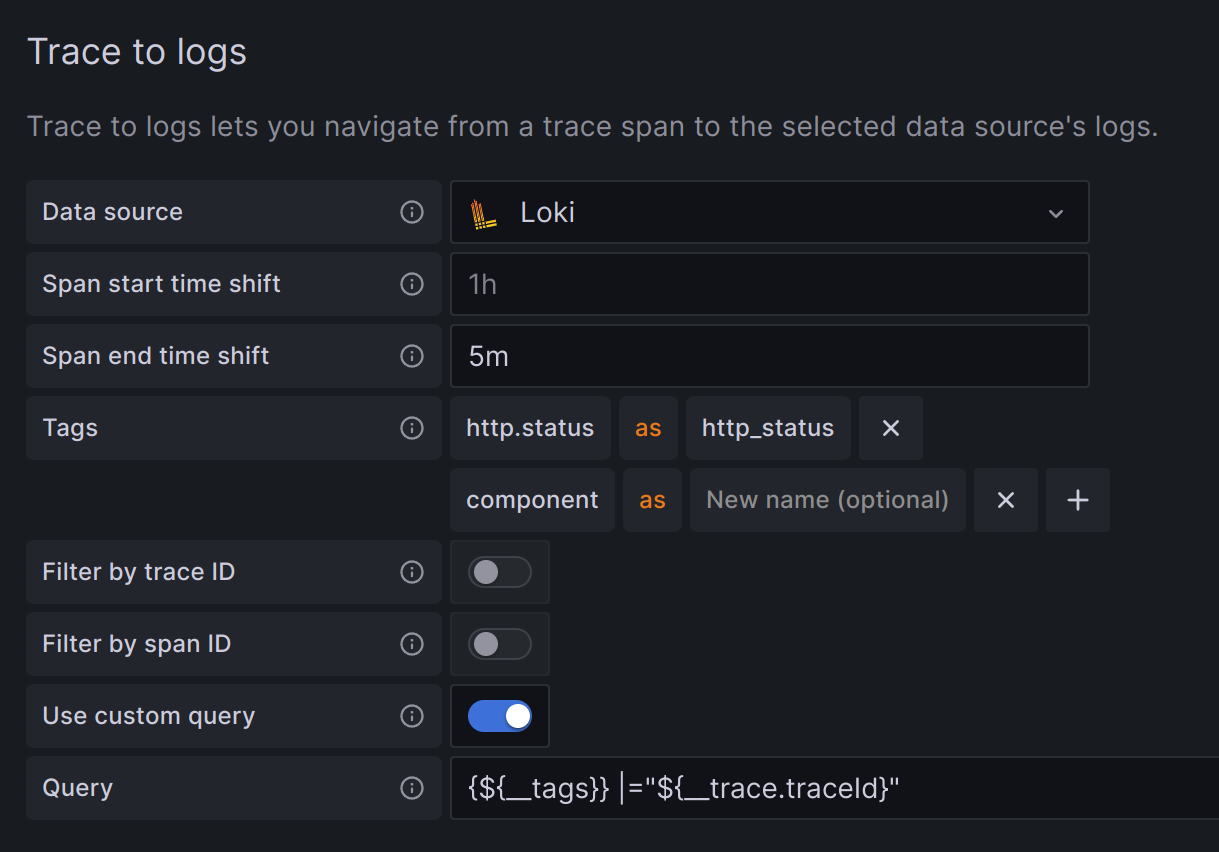

Trace to logs
Trace to logs settings
Note
Available in Grafana v7.4 and higher. If you use Grafana Cloud, open a support ticket in the Cloud Portal to access this feature.
The Trace to logs setting configures the trace to logs feature that is available when you integrate Grafana with Jaeger.
There are two ways to configure the trace to logs feature:
  • Use a simplified configuration with default query, or
  • Configure a custom query where you can use a template language to interpolate variables from the trace or span.
Use a simple configuration
  1. Select the target data source.
  2. Set start and end time shift. Since the logs timestamps may not exactly match the timestamps of the spans in trace, it may be necessary to search in larger or shifted time range to find the desired logs.
  3. Select which tags to use in the logs query. The tags you configure must be present in the spans attributes or resources for a trace to logs span link to appear. You can optionally configure a new name for the tag. This is useful if the tag has dots in the name and the target data source does not allow dots in labels. In that case, you can, for example, remap http.status to http_status.
  4. Optionally, switch on the Filter by trace ID and/or Filter by span ID setting to further filter the logs if your logs consistently contain trace or span IDs.
  2. Set start and end time shift. Since the logs timestamps may not exactly match the timestamps of the spans in the trace, you may need to widen or shift the time range to find the desired logs.
  3. Optionally, select tags to map. These tags can be used in the custom query with ${__tags} variable. This variable will interpolate the mapped tags as a list in an appropriate syntax for the data source and will only include the tags that were present in the span omitting those that weren’t present. You can optionally configure a new name for the tag. This is useful in cases where the tag has dots in the name and the target data source does not allow dots in labels. For example, you can remap http.status to http_status. If you don’t map any tags here, you can still use any tag in the query like this method="${__span.tags.method}".
  4. Skip Filter by trace ID and Filter by span ID settings as these cannot be used with a custom query.
  5. Switch on Use custom query.
  6. Specify a custom query to be used to query the logs. You can use various variables to make that query relevant for current span. The link is present only if all the variables are interpolated with non-empty values to prevent creating an invalid query.
Variables that can be used in a custom query
To use a variable you need to wrap it in ${}. For example: ${__span.name}.
Variable nameDescription
__tagsThis variable uses the tag mapping from the UI to create a label matcher string in the specific data source syntax. The variable only uses tags that are present in the span. The link is still created even if only one of those tags is present in the span. You can use this if all tags are not required for the query to be useful.
__span.spanIdThe ID of the span.
__span.traceIdThe ID of the trace.
__span.durationThe duration of the span.
__span.nameName of the span.
__span.tagsNamespace for the tags in the span. To access a specific tag named version, you would use ${__span.tags.version}. In case the tag contains dot, you have to access it as ${__span.tags["http.status"]}.
__trace.traceIdThe ID of the trace.
__trace.durationThe duration of the trace.
__trace.nameThe name of the trace.
The following table describes the ways in which you can configure your trace to logs settings:
Setting nameDescription
Data sourceDefines the target data source. You can select only Loki or Splunk [logs] data sources.
Span start time shiftShifts the start time for the logs query, based on the span’s start time. You can use time units, such as 5s, 1m, 3h. To extend the time to the past, use a negative value. Default: 0.
Span end time shiftShifts the end time for the logs query, based on the span’s end time. You can use time units. Default: 0.
TagsDefines the tags to use in the logs query. Default: cluster, hostname, namespace, pod. You can change the tag name for example to remove dots from the name if they are not allowed in the target data source. For example, map http.status to http_status.
Filter by trace IDToggles whether to append the trace ID to the logs query.
Filter by span IDToggles whether to append the span ID to the logs query.
Use custom queryToggles use of custom query with interpolation.
QueryInput to write custom query. Use variable interpolation to customize it with variables from span.

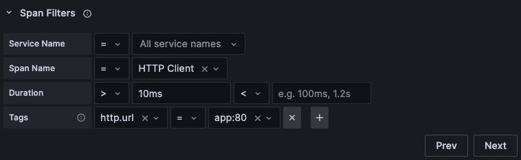

Span Filters
Note
This feature is behind the newTraceViewHeader feature toggle. If you use Grafana Cloud, open a support ticket in the Cloud Portal to access this feature.
Screenshot of span filtering
Using span filters, you can filter your spans in the trace timeline viewer. The more filters you add, the more specific are the filtered spans.
You can add one or more of the following filters:
  • Service name
  • Span name
  • Duration
  • Tags (which include tags, process tags, and log fields)
