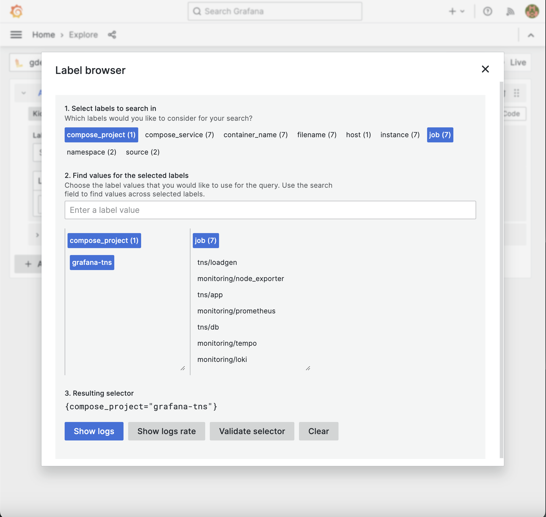

- Label browser - Use the Loki label browser to navigate through your labels and values, and build queries.
To navigate Loki and build a query:
Choose labels to locate.
Search for the values of your selected labels.
The search field supports fuzzy search, and the label browser also supports faceting to list only possible label combinations.
Select the Show logs button to display log lines based on the selected labels, or select the Show logs rate button to show the rate based on metrics such as requests per second. Additionally, you can validate the selector by clicking the Validate selector button. Click Clear to start from the beginning.

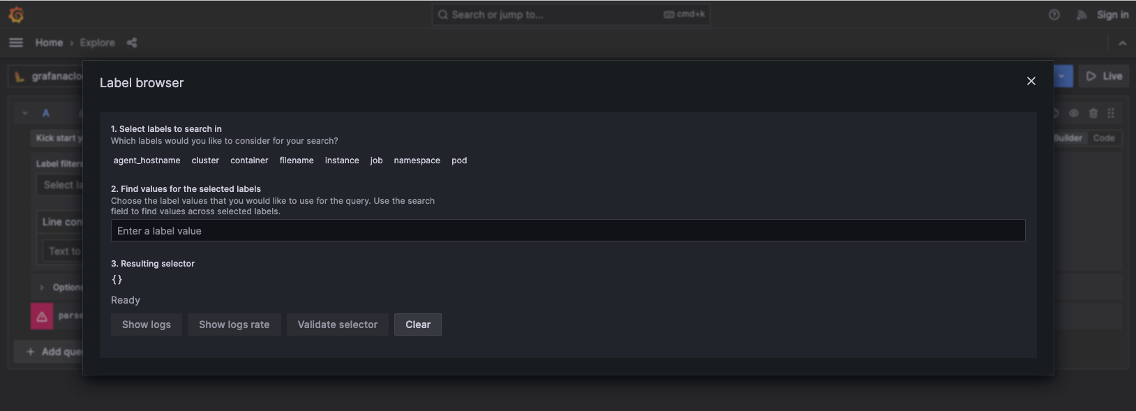

Label browser
You can use the Loki label browser to navigate through your labels and values, and build queries.
