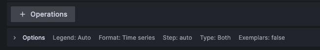

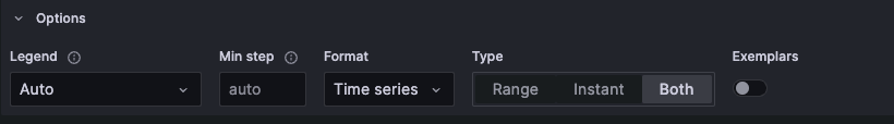

Configure common options
You can configure Prometheus-specific options in the query editor by setting several options regardless of mode.
Legend
The Legend setting defines the time series’s name. You can use a predefined or custom format.
- Auto - Displays unique labels. Also displays all overlapping labels if a series has multiple labels.
- Verbose - Displays all label names.
- Custom - Uses templating to select which labels will be included. For example,
{{hostname}}is replaced by the label value for the labelhostname. Clear the input and click outside of it to select another mode.
Min step
The Min step setting defines the lower bounds on the interval between data points.
For example, set this to 1h to hint that measurements are taken hourly.
This setting supports the $__interval and $__rate_interval macros.
Format
Switch between the following format options:
- Time series - The default time series format. See Time series kind formats for information on time series data frames and how time and value fields are structured.
- Table - This works only in a Table panel.
- Heatmap - Displays metrics of the Histogram type on a Heatmap panel by converting cumulative histograms to regular ones and sorting the series by the bucket bound.
Type
The Type setting sets the query type. These include:
- Both - The default option. Returns results for both a Range query and an Instant query.
- Range - Returns a range vector consisting of a set of time series data containing a range of data points over time for each time series. You can choose lines, bars, points, stacked lines or stacked bars
- Instant - Returns one data point per query and only the most recent point in the time range provided. The results can be shown in table format or as raw data. To depict instant query results in the time series panel, first add a field override, next add a property to the override named
Transform, and finally selectConstantfrom the Transform dropdown.
For more information, refer to the Time Series Transform option documentation.
Note
Grafana modifies the request dates for queries to align them with the dynamically calculated step. This ensures a consistent display of metrics data, but it can result in a small gap of data at the right edge of a graph.
Exemplars
Toggle Exemplars to run a query that includes exemplars in the graph. Exemplars are unique to Prometheus. For more information see Introduction to exemplars.
Note
There is no option to add exemplars with an Instant query type.

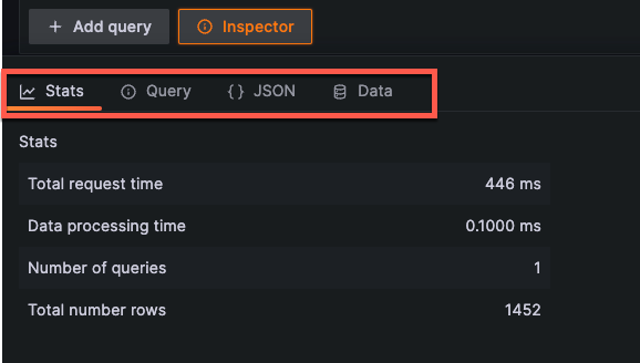

Inspector
Click Inspector to get detailed statistics regarding your query. Inspector functions as a kind of debugging tool that “inspects” your query. It provides query statistics under Stats, request response time under Query, data frame details under {} JSON, and the shape of your data under Data.

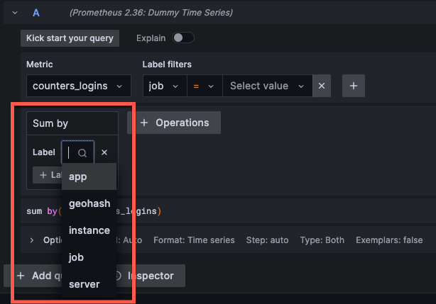

Builder mode
Builder mode helps you build queries using a visual interface. This option is best for users who have limited or no previous experience working with Prometheus and PromQL.
This video demonstrates how to use the visual Prometheus query builder available in Grafana v9.0:
There’s supposed to be a video here, but for some reason there isn’t. Either we entered the id wrong (oops!), or Vimeo is down. If it’s the latter, we’d expect they’ll be back up and running soon. In the meantime, check out our blog!

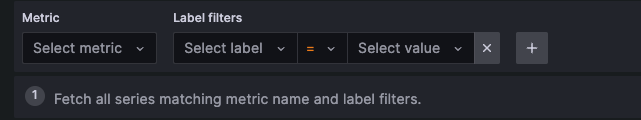

Metrics
When you are ready to create a query, you can choose the specific metric name from the dropdown list under Metric. The data source requests the list of available metrics from the Prometheus server based on the selected time rage. You can also enter text into the selector when the dropdown is open to search and filter the list.
Label filters
Select desired labels and their values from the dropdown list.
When a metric is selected, the data source requests available labels and their values from the server.
Use the + button to add a label, and the x button to remove a label.

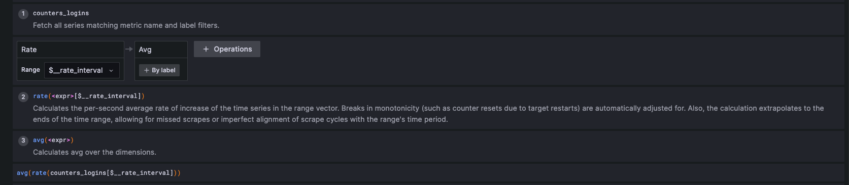

Operations
Select the + Operations button to add operations to your query.
The query editor groups operations into the following sections:
- Aggregations - for additional information see Aggregation operators.
- Range functions - for additional information see Functions.
- Functions - for additional information see Functions.
- Binary operations - for additional information see Binary operators.
- Trigonometric - for additional information see Trigonometric functions.
- Time functions - for additional information see Functions.
All operations have function parameters under the operation header. Click the operator to see a full list of supported functions. Some operations allow you to apply specific labels to functions.
Some operations make sense only when used in a specific order. If adding an operation would result in nonsensical query, the query editor adds the operation to the correct place.

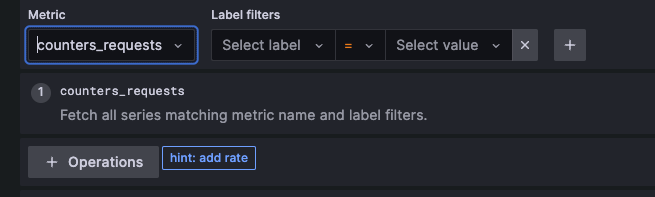

Hints
The query editor can detect which operations are most appropriate for some selected metrics. If it does, it displays a hint next to the + Operations button.
To add the operation to your query, click the Hint.

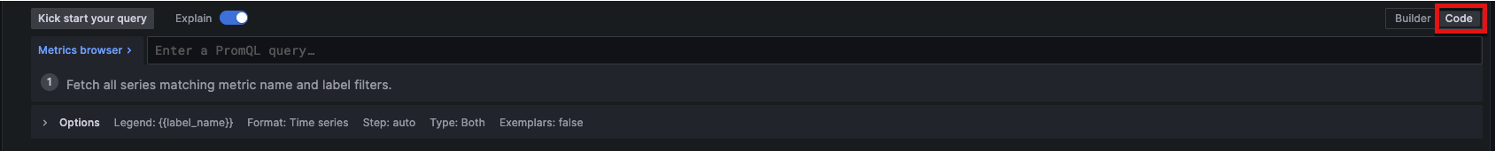

Code mode
Code mode is for the experienced Prometheus user with prior expertise in PromQL, Prometheus’ query language. The Code mode editor allows you to create queries just as you would in Prometheus. For more information about PromQL see Querying Prometheus.
The user interface (UI) also lets you select metrics, labels, filters and operations.
You can write complex queries using the text editor with autocompletion features and syntax highlighting. It also contains a Metrics browser to further help you write queries.

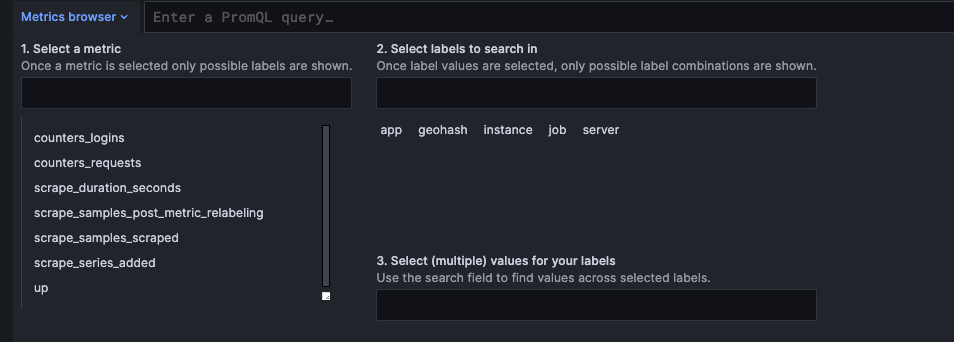

Metrics browser
The metrics browser locates metrics and selects relevant labels to help you build basic queries.
When you click Metrics browser, it displays all available metrics and labels.
If supported by your Prometheus instance, each metric also displays its HELP and TYPE as a tooltip.
When you select a metric under Step 1, the browser narrows down the available labels to show only the ones applicable to the metric.
You can then select one or more labels shown in Step 2.
Select one or more values in Step 3 for each label to tighten your query scope.
In Step 4, you can select Use query to run the query, Use as rate query to add the rate operation to your query ($__rate_interval), Validate selector to verify the selector is valid and show the number of series found, or Clear to clear your selections and start over.
