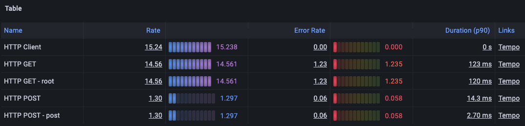

Open the Service Graph view
Service graph view displays a table of request rate, error rate, and duration metrics (RED) calculated from your incoming spans. It also includes a node graph view built from your spans.
Screenshot of the Service Graph view
For details, refer to the Service Graph view documentation.
To open the Service Graph view:
  1. Link a Prometheus data source in the Tempo data source settings.
  2. Navigate to Explore.
  3. Select the Tempo data source.
  4. Select the Service Graph query type.
  5. Run the query.
  6. (Optional) Filter your results.
Note
Grafana uses the traces_spanmetrics_calls_total metric to display the name, rate, and error rate columns, and traces_spanmetrics_latency_bucket to display the duration column. These metrics must exist in your Prometheus data source.
To open a query in Prometheus with the span name of that row automatically set in the query, click a row in the rate, error rate, or duration columns.
To open a query in Tempo with the span name of that row automatically set in the query, click a row in the links column.
