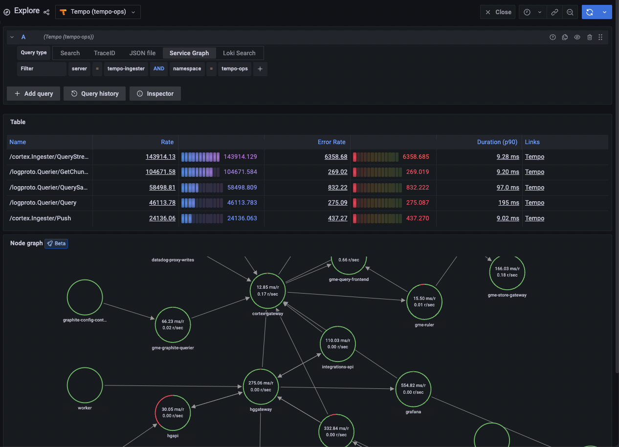

Node Graph
You can optionally expand the node graph for the displayed trace. Depending on the data source, this can show spans of the trace as nodes in the graph, or as some additional context like service graph based on the current trace.
Service Graph
The Service Graph visualizes the span metrics (traces data for rates, error rates, and durations (RED)) and service graphs. Once the requirements are set up, this pre-configured view is immediately available.
For more information, refer to the Service Graph view section of the Tempo data source page and the service graph view page in the Tempo documentation.
