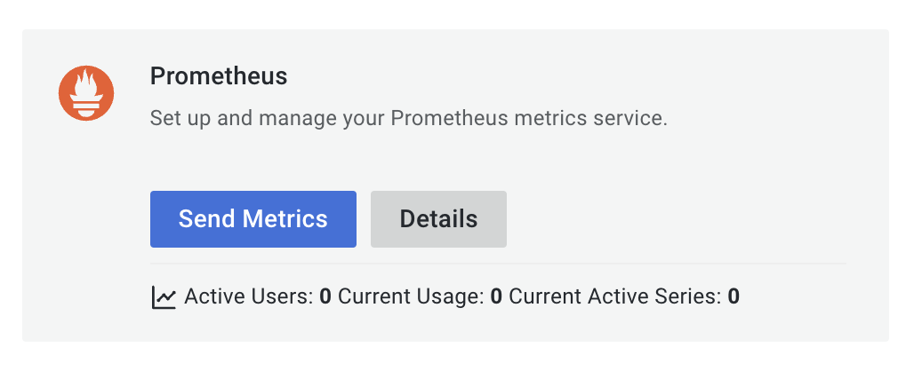

- Sign up for https://grafana.com/. Grafana gives you a Prometheus instance out of the box.
- Because you are running your own Prometheus instance locally, you must
remote_writeyour metrics to the Grafana.com Prometheus instance. Grafana provides code to add to yourprometheus.ymlconfig file. This includes a remote write endpoint, your user name and password.
