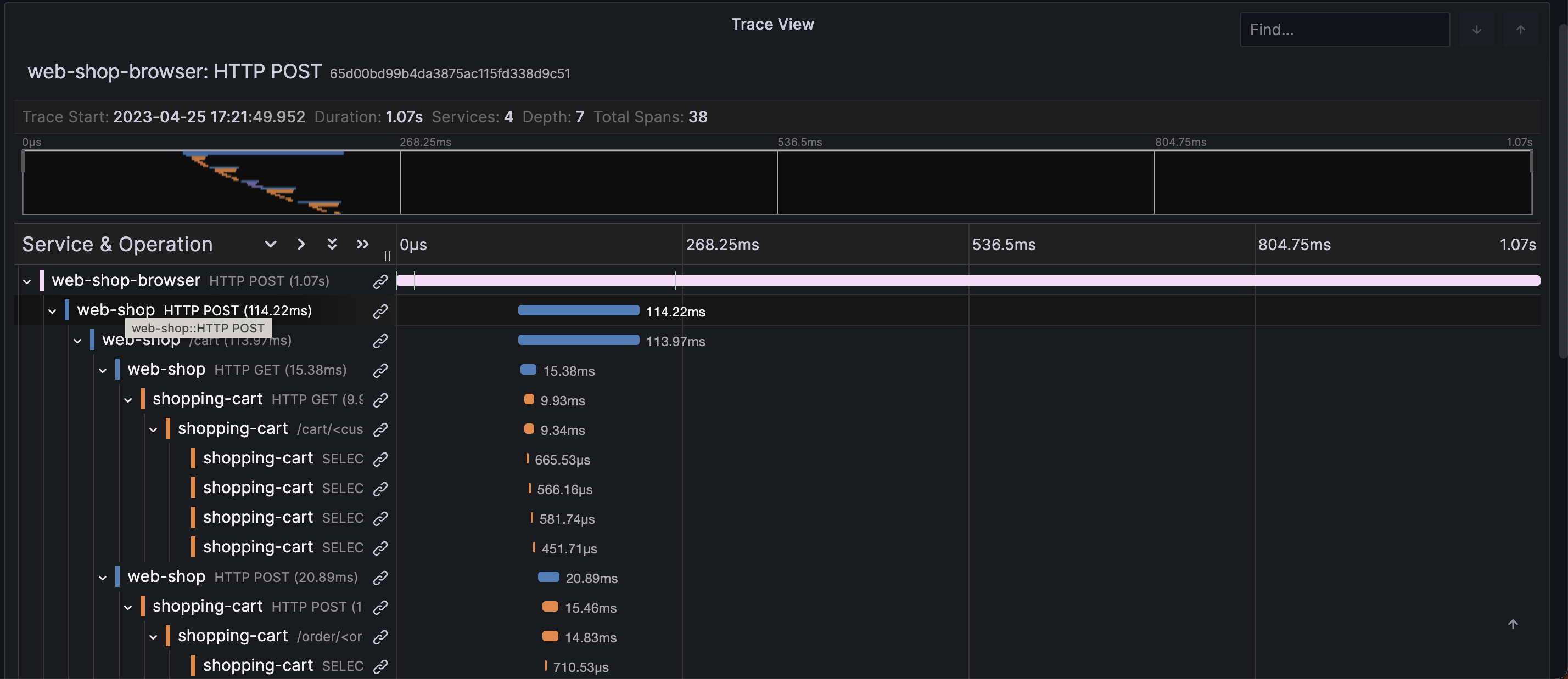

Traces visualizations let you follow a request as it traverses the services in your infrastructure. The traces visualization displays traces data in a diagram that allows you to easily interpret it.

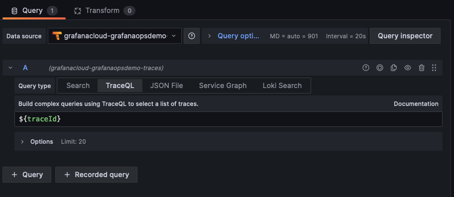

In the query editor, select the TraceQL query type tab.
Enter
${traceId}in the TraceQL query field to create a dashboard variable. This variable is used as the template query.![Add a template query Add a template query]()
Add a template query Select Apply in the panel editor to add the panel to the dashboard.

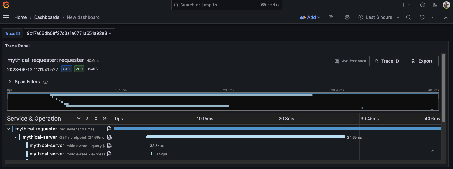

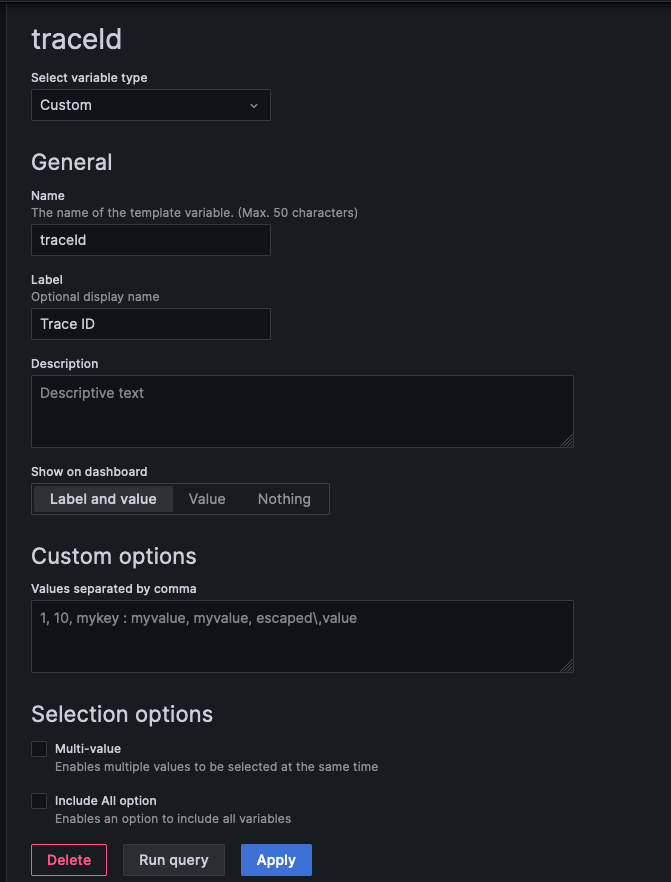

Go to the dashboard Settings and add a new variable called
traceId, of variable type Custom, giving it a label if required. Select Apply to add the variable to the dashboard.![Add a Custom variable Add a Custom variable]()
Add a Custom variable Verify that the panel works by using a valid trace ID for the data source used for the trace panel and editing the ID in the dashboard variable.

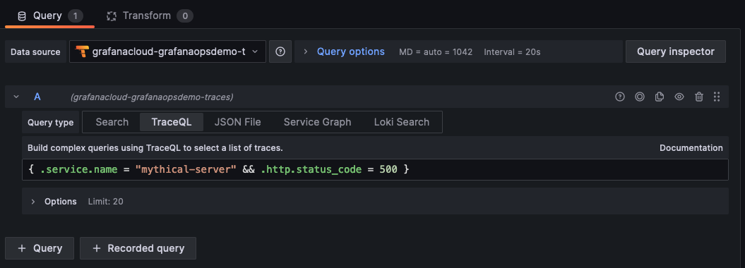

In the query editor, select the TraceQL tab.
Under the Panel options, enter a Title for your trace panel.

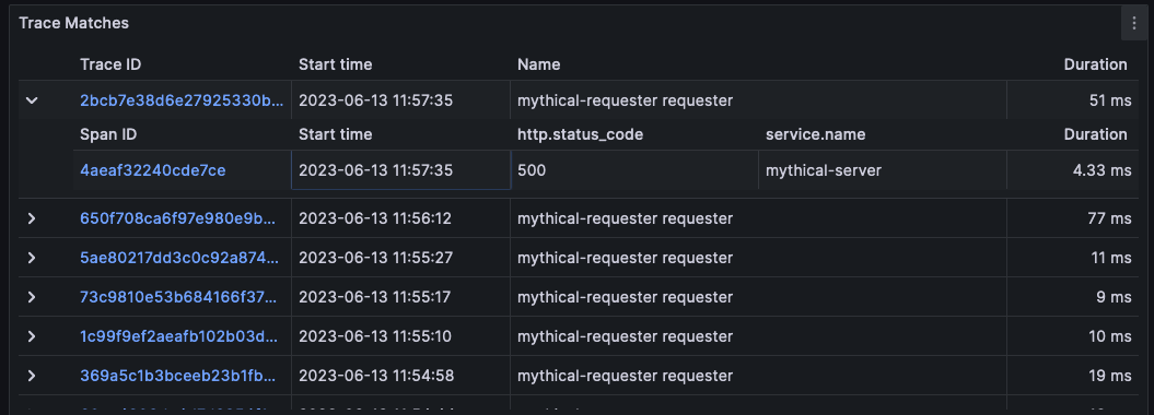

Add an appropriate TraceQL query to search for traces that you would like to visualize in the dashboard. This example uses a simple, static query. You can write the TraceQL query as a template query to take advantage of other dashboard variables, if they exist. This lets you create dynamic queries based on these variables.
![Create a dynamic query Create a dynamic query]()

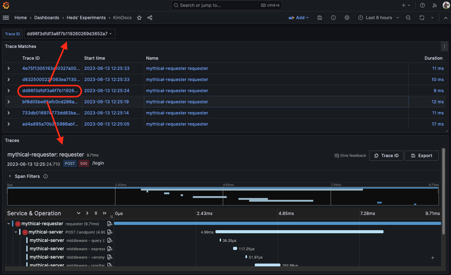

When results are returned from a query, the results are rendered in the panel’s table.

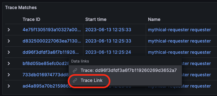

Use a variable to add other links to traces
The results in the traces visualization include links to the Explore page that renders the trace. You can add other links to traces in the table that fill in the traceId dashboard variable when selected, so that the trace is visualized in the same dashboard.
To create a set of data links in the panel, use the following steps:

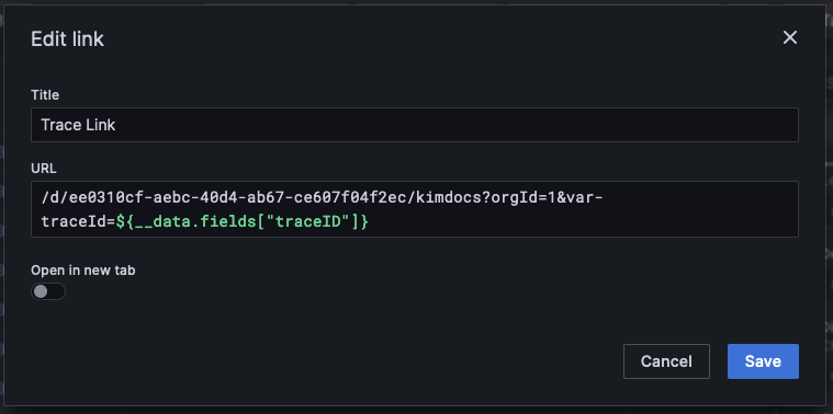

In the right-side menu, under Data links, select Add link.
Add a Title for the data link.
Find the UUID of the dashboard by looking in your browser’s address bar when the full dashboard is being rendered. Because this is a link to a dashboard in the same Grafana stack, only the path of the dashboard is required.
![Unique identifier for the dashboard Unique identifier for the dashboard]()
Unique identifier for the dashboard In the URL field, make a self-reference to the dashboard that contains both of the panels. This self-reference uses the value of the selected trace in the table to fill in the dashboard variable. Use the path for the dashboard from the previous step and then fill in the value of
traceIdusing the selected results from the TraceQL table. The trace ID is exposed using thetraceIDdata field in the returned results, so use that as the value for the dashboard variable.![Edit link and add the Trace link Edit link and add the Trace link]()
Edit link and add the Trace link Select Save to save the data link.
Select Apply from the panel editor to apply the panel to the dashboard.
Save the dashboard.
You should now see a list of matching traces in the table visualization. While selecting the TraceID or SpanID fields will give you the option to either open the Explore page to visualize the trace or following the data link, selecting any other field (such as Start time, Name or Duration) automatically follows the data link, filling in the traceId dashboard variable, and then shows the relevant trace in the trace panel.
