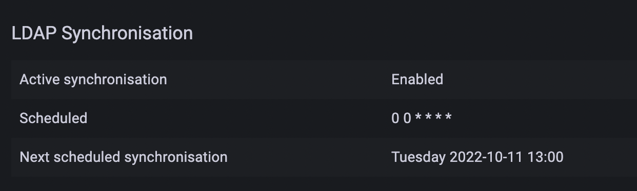

Grafana Enterprise users with enhanced LDAP integration enabled can also see sync status in the debug view. This requires the ldap.status:read permission.
