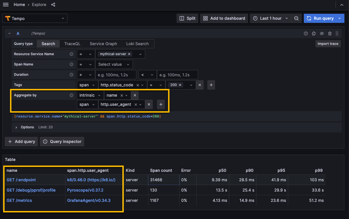

Optional: Use Aggregate by
Warning
Aggregate by is an experimental feature. Engineering and on-call support is not available. Documentation is either limited or not provided outside of code comments. No SLA is provided. Enable the
metricsSummaryfeature toggle in Grafana to use this feature. Your Grafana Tempo data source must also point to a Tempo database with the Metrics Summary API enabled. Contact Grafana Support to enable this feature in Grafana Cloud.
Using Aggregate by, you can calculate RED metrics (total span count, percent erroring spans, and latency information) for spans of kind=server that match your filter criteria, grouped by one or more attributes.
This capability is based on the metrics summary API.
Metrics summary only calculates summaries based on spans received within the last hour.
When you use Aggregate by, the selections you make determine how the information is reported in the Table. Every combination that matches selections in your data is listed in the table.
Each aggregate value, for example intrinsic:name, has a corresponding column in the results table.
For example, names matching GET /:endpoint with a span.http.user_agent of k6/0.46 appeared in 31,466 spans. Instead of being listed by traces and associated spans, the query results are grouped by the selections in Aggregate by.
The RED metrics are calculated for every name and user agent combination found in your data.
The screenshot shows all of the successful HTTP status_code API calls against the mystical-server service.
The results are shown in the same order used in Aggregate by.
For example, Aggregate by lists intrinsic.name followed by span.http.user_agent.
The first column in the results Table shows name and then span.http.user_agent.
