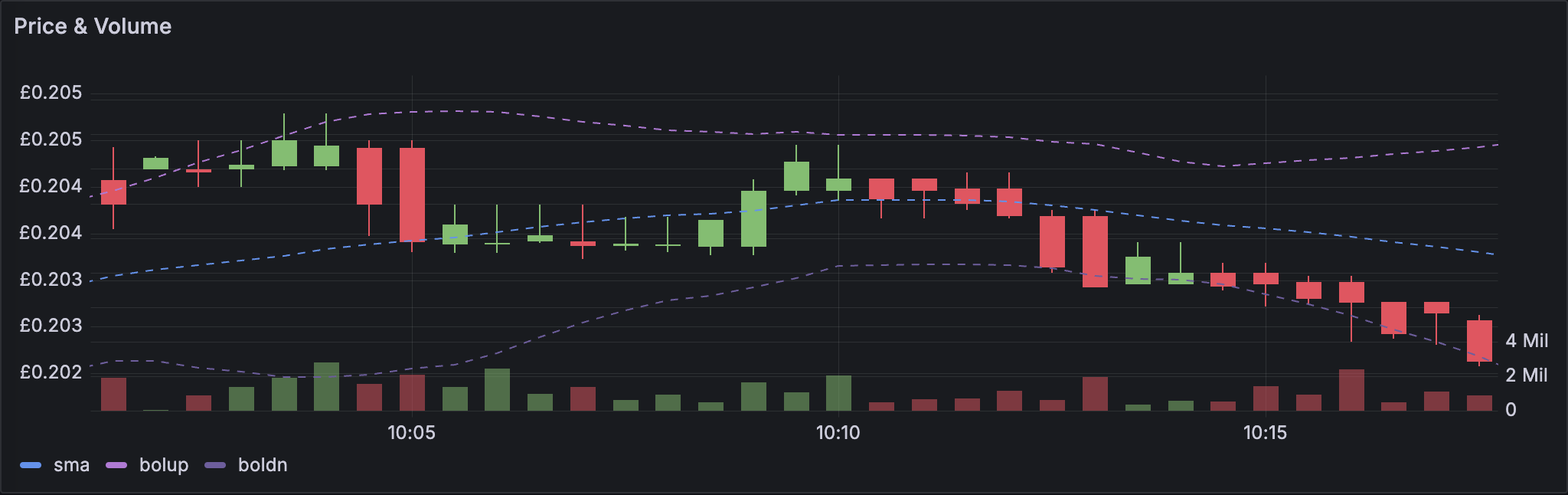

The candlestick visualization allows you to visualize data that includes a number of consistent dimensions focused on price movements, such as stock prices. The candlestick visualization includes an Open-High-Low-Close (OHLC) mode, as well as support for additional dimensions based on time series data.
Candlestick visualizations build upon the foundation of the time series visualization and include many common configuration settings.
You can use a candlestick if you want to visualize, at a glance, how a price moved over time, whether it went up, down, or stayed the same, and how much it fluctuated:
Each candlestick is represented as a rectangle, referred to as the candlestick body. The candlestick body displays the opening and closing prices during a time period. Green candlesticks represent when the price appreciated while the red candlesticks represent when the price depreciated. The lines sticking out the candlestick body are referred to as wicks or shadows, which represent the highest and lowest prices during the time period.

- Candles limits the panel dimensions to the open, high, low, and close dimensions used by candlestick visualizations.
- Volume limits the panel dimension to the volume dimension.
- Both is the default behavior for the candlestick visualization. It includes both candlestick and volume visualizations.
