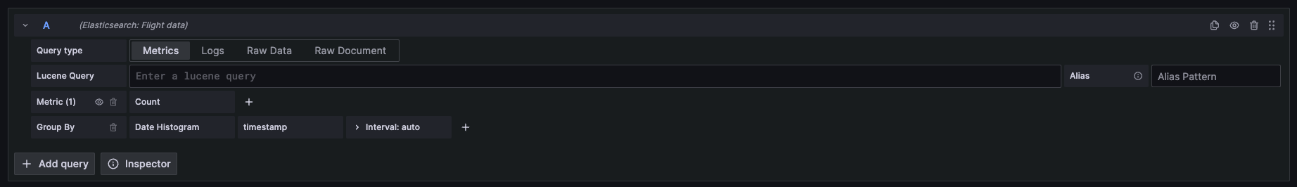

Metrics query type
Metrics queries aggregate data and produce a variety of calculations such as count, min, max, etc. Click on the metric box to view a list of options in the dropdown menu. The default is count.

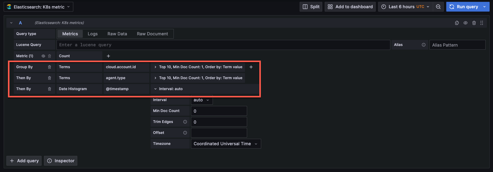

The nested group by option is currently experimental, you can select a field and then settings specific to that field.
Click the + sign to add multiple group by options. The data will grouped in order (first by, then by).
