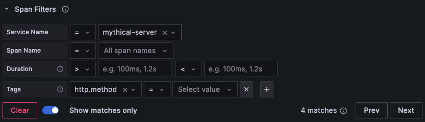

Span Filters
Screenshot of span filtering
Using span filters, you can filter your spans in the trace timeline viewer. The more filters you add, the more specific are the filtered spans.
You can add one or more of the following filters:
  • Service name
  • Span name
  • Duration
  • Tags (which include tags, process tags, and log fields)
To only show the spans you have matched, you can press the Show matches only toggle.
