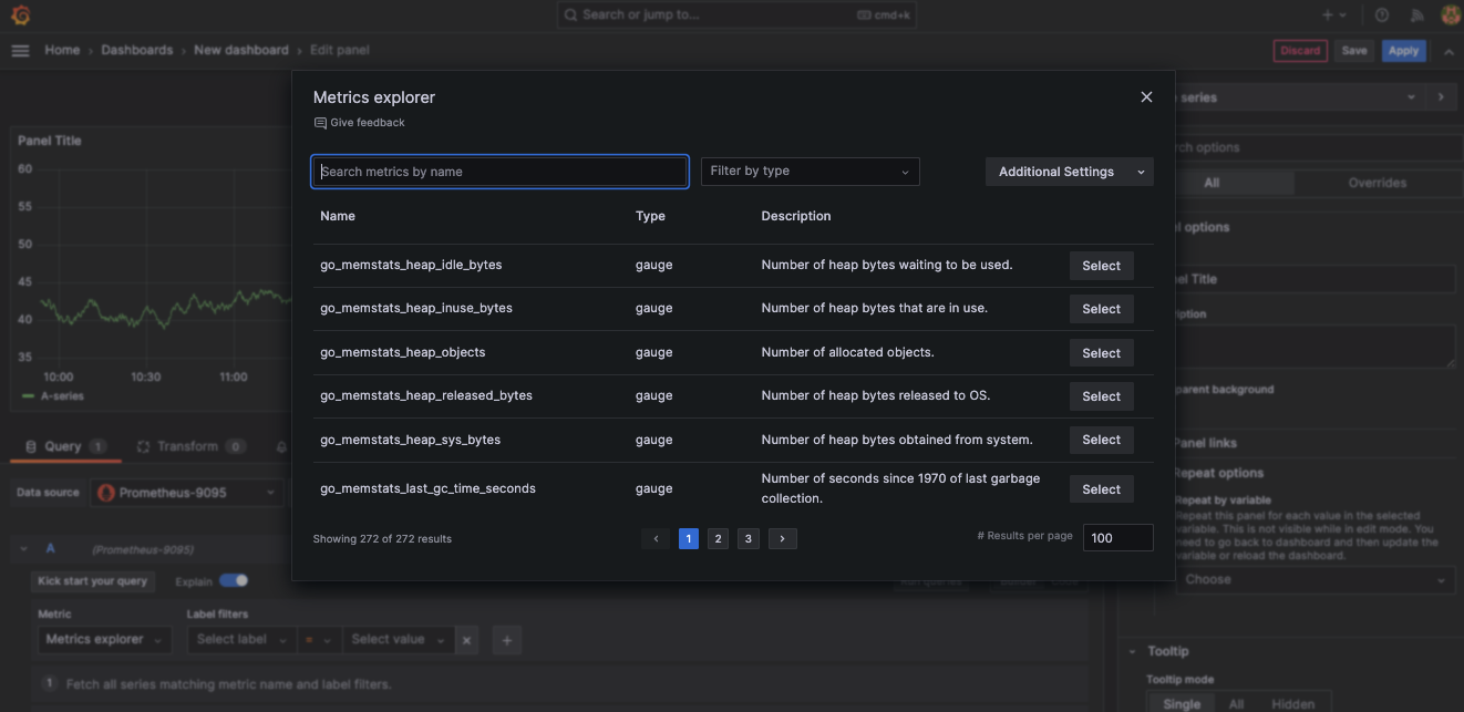

Metrics explorer
If you would like to explore your metrics in the query builder further, you can open the Metrics Explorer by clicking the first option in the metric select component of the query builder.
The metrics explorer is different than the metrics browser. The metrics explorer is only found in the query builder section. The metrics browser is only found in the code editor. The metrics explorer does not have the ability to browse labels yet, but the metrics browser can display all labels on a metric name.
The metrics explorer displays all metrics in a paginated table list. The list shows the total number of metrics, as well as the name, type and description for each metric. You can enter text into the search input to filter results. You can also filter by type.
There are also additional settings for the following items:
- Include description in search. Search by name and description
- Include results with no metadata. Many Prometheus metrics have no metadata. This allows users to include metrics with undefined type and description.
- Disable text wrap.
- Enable regex search. This uses the Prometheus API to enable regex search for the metric name.
