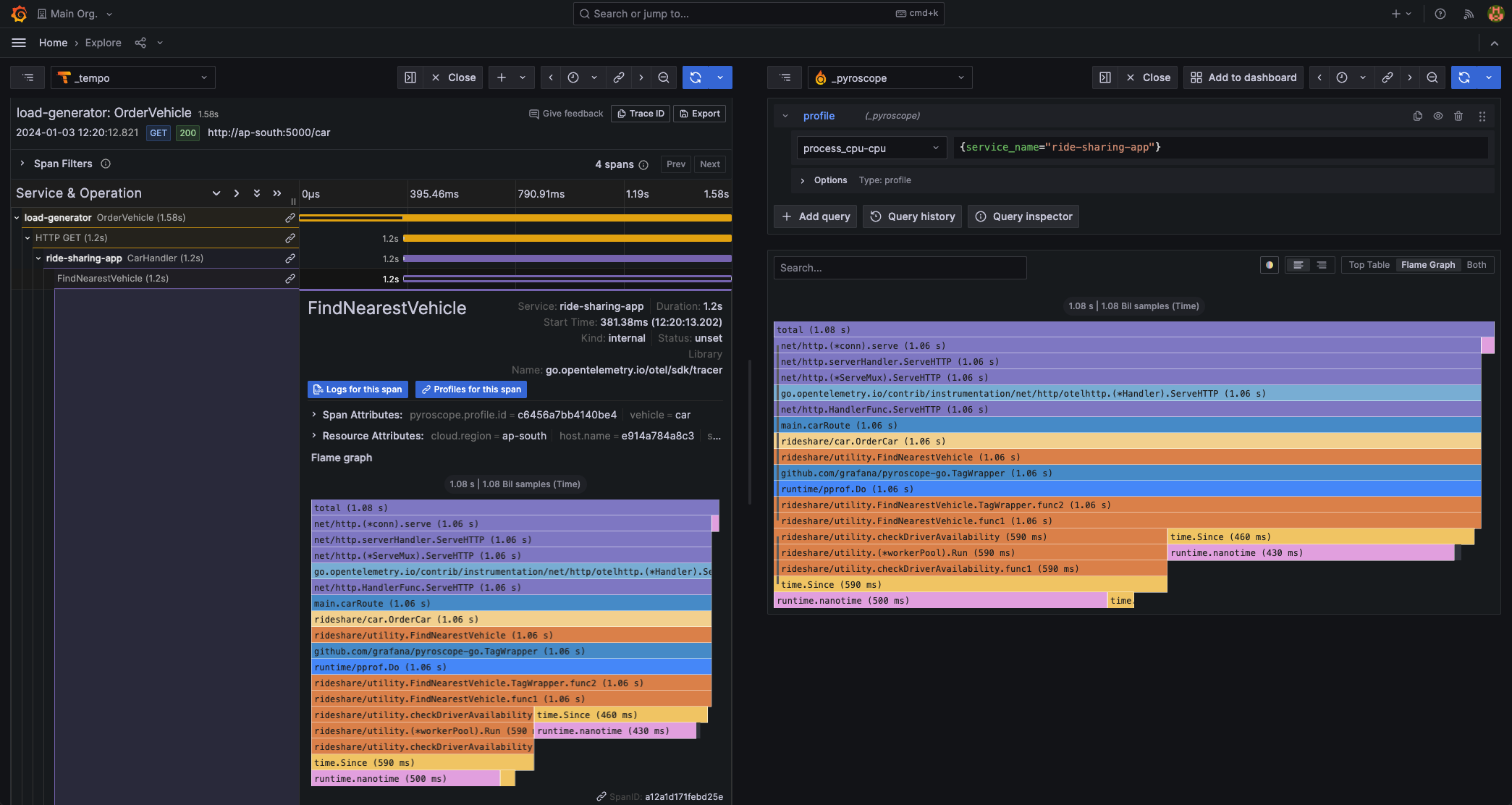

To use trace to profiles, navigate to Explore and query a trace. Each span links to your queries. Clicking a link runs the query in a split panel. If tags are configured, Grafana dynamically inserts the span attribute values into the query. The query runs over the time range of the (span start time - 60) to (span end time + 60 seconds).
To use trace to profiles, you must have a configured Grafana Pyroscope data source. For more information, refer to the Grafana Pyroscope data source documentation.
Embedded flame graphs are also inserted into each span details section that has a linked profile. This lets you see resource consumption in a flame graph visualization for each span without having to navigate away from the current view. Hover over a particular block in the flame graph to see more details about the consumed resources.

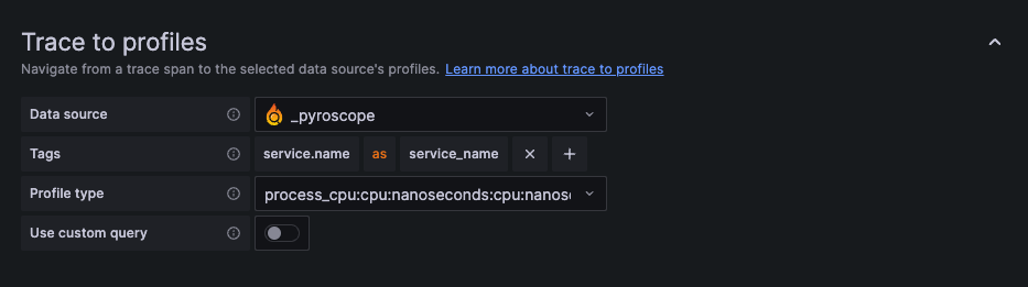

Use a basic configuration
To use a basic configuration, follow these steps:
Select a Pyroscope data source from the Data source drop-down.
Optional: Choose any tags to use in the query. If left blank, the default values of
service.nameandservice.namespaceare used.The tags you configure must be present in the spans attributes or resources for a trace-to-profiles span link to appear.
You can optionally configure a new name for the tag. This is useful if the tag has dots in the name and the target data source doesn’t allow dots in labels. In that case, you can remap
service.nametoservice_name.Select one or more profile types to use in the query. Select the drop-down and choose options from the menu.
The profile type or app must be selected for the query to be valid. Grafana doesn’t show any data if the profile type or app isn’t selected when a query runs.
![Traces to profile configuration options in the Tempo data source]()
Do not select Use custom query.
Select Save and Test.
