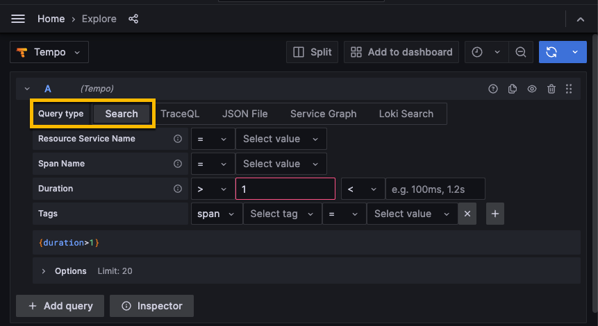

The TraceQL query builder, located on the Explore > Query type > Search in Grafana, provides drop-downs and text fields to help you write a query.
The builder lets you run the most common queries in as few clicks as possible. You don’t need to know the underlying query language or database architecture to use it.
The builder supports a subset of TraceQL capabilities. For example, if you wish to use structural operators (>>, >, ~), you need to use the query editor on the TraceQL tab.
You can use the query builder’s drop-downs to compose TraceQL queries. The selections you make automatically generate a TraceQL query.

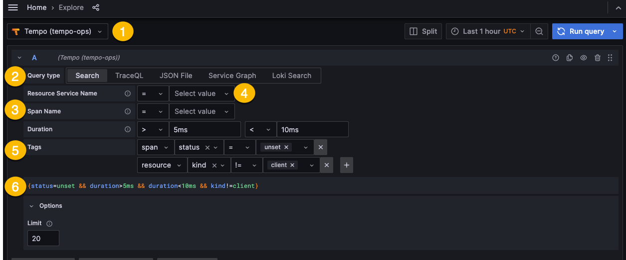

To access Search, select your Tempo data source, and then choose Explore and select Query type > Search. You can use the query builder to search trace data by resource service name, span name, duration, and one or more tags. The examples on this page use the default filters.
In addition, you can add query builder blocks, view the query history, and use the Inspector to see details.
Perform a search
To perform a search, you need to select filters and/or tags and then run the query. The results appear underneath the query builder. The screenshot identifies the areas used to perform a search.

Define filters
Using filters, you refine the data returned from the query by selecting Resource Service Name, Span Name, or Duration. The Duration represents span time, calculated by subtracting the end time from the start time of the span.
Grafana administrators can change the default filters using the Tempo data source configuration.
Filters can be limited by the operators. The available operators are determined by the field type.
For example, Span Name and Resource Service Name are string fields so the comparison operators are equals (=), not equal (!=), or regular expressions (=~).
Duration is a duration field type and uses range selections (>, >=, <, <=).
When you select multiple values for the same filter, Grafana automatically changes the operator to the regex operator =~ and concatenates the values with a |. This capability only applies to fields with drop-down value selection.
For example, if you choose Span Name = get and then Span Name = log_results_cache, operator drop-down changes from = to =~ and both get and log_results_cache are listed in the Span Name field. The resulting query is updated with this:
{duration>5ms && duration<10ms && name=~"get|log_results_cache"}
To define filters, follow these steps:
- Choose one of the filters.
- Select a comparison operator from the drop-down.
- Resource Service Name and Span Name only: Select one or more values from the drop-down.
- Duration only: Enter values and units for the range and choose comparison operators for the drop-downs. Units can be nanoseconds (
ns), milliseconds (ms), seconds (s), minutes (m), and hours (h).
You can either select Run query to execute the query or define tags and then run the query.

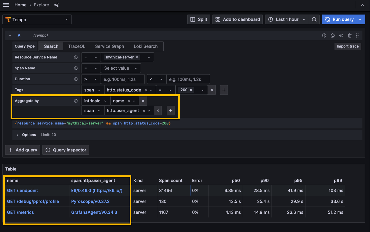

Optional: Use Aggregate by
Warning
Aggregate by is an experimental feature. Engineering and on-call support is not available. Documentation is either limited or not provided outside of code comments. No SLA is provided. Enable the
metricsSummaryfeature toggle in Grafana to use this feature. Your Grafana Tempo data source must also point to a Tempo database with the Metrics Summary API enabled. Contact Grafana Support to enable this feature in Grafana Cloud.
Using Aggregate by, you can calculate RED metrics (total span count, percent erroring spans, and latency information) for spans of kind=server that match your filter criteria, grouped by one or more attributes.
This capability is based on the metrics summary API.
Metrics summary only calculates summaries based on spans received within the last hour.
For additional information, refer to Traces to metrics: Ad-hoc RED metrics in Grafana Tempo with Aggregate by.
When you use Aggregate by, the selections you make determine how the information is reported in the Table. Every combination that matches selections in your data is listed in the table.
Each aggregate value, for example intrinsic:name, has a corresponding column in the results table.
For example, names matching GET /:endpoint with a span.http.user_agent of k6/0.46 appeared in 31,466 spans. Instead of being listed by traces and associated spans, the query results are grouped by the selections in Aggregate by.
The RED metrics are calculated for every name and user agent combination found in your data.
The screenshot shows all of the successful HTTP status_code API calls against the mystical-server service.
The results are shown in the same order used in Aggregate by.
For example, Aggregate by lists intrinsic.name followed by span.http.user_agent.
The first column in the results Table shows name and then span.http.user_agent.
To use this capability:
- In the Aggregate by row, select a scope from the first drop-down box. For example,
span. - Select an attribute from the second drop-down.
- Optional: Select + to add an Aggregate by row.
- Optional: Select a Time range to expand or narrow the data set for an hour’s range.
- Select Run query.

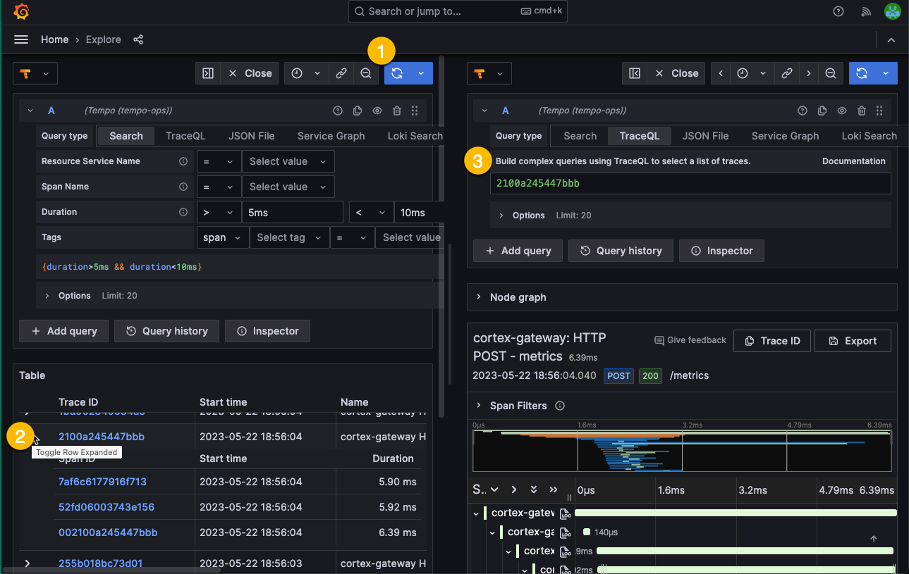

Run queries and view results
Select Run query to run the TraceQL query (1 in the screenshot).
Queries can take a little while to return results. The results appear in a table underneath the query builder. Selecting a Trace ID (2 in the screenshot) displays more detailed information (3 in the screenshot).
