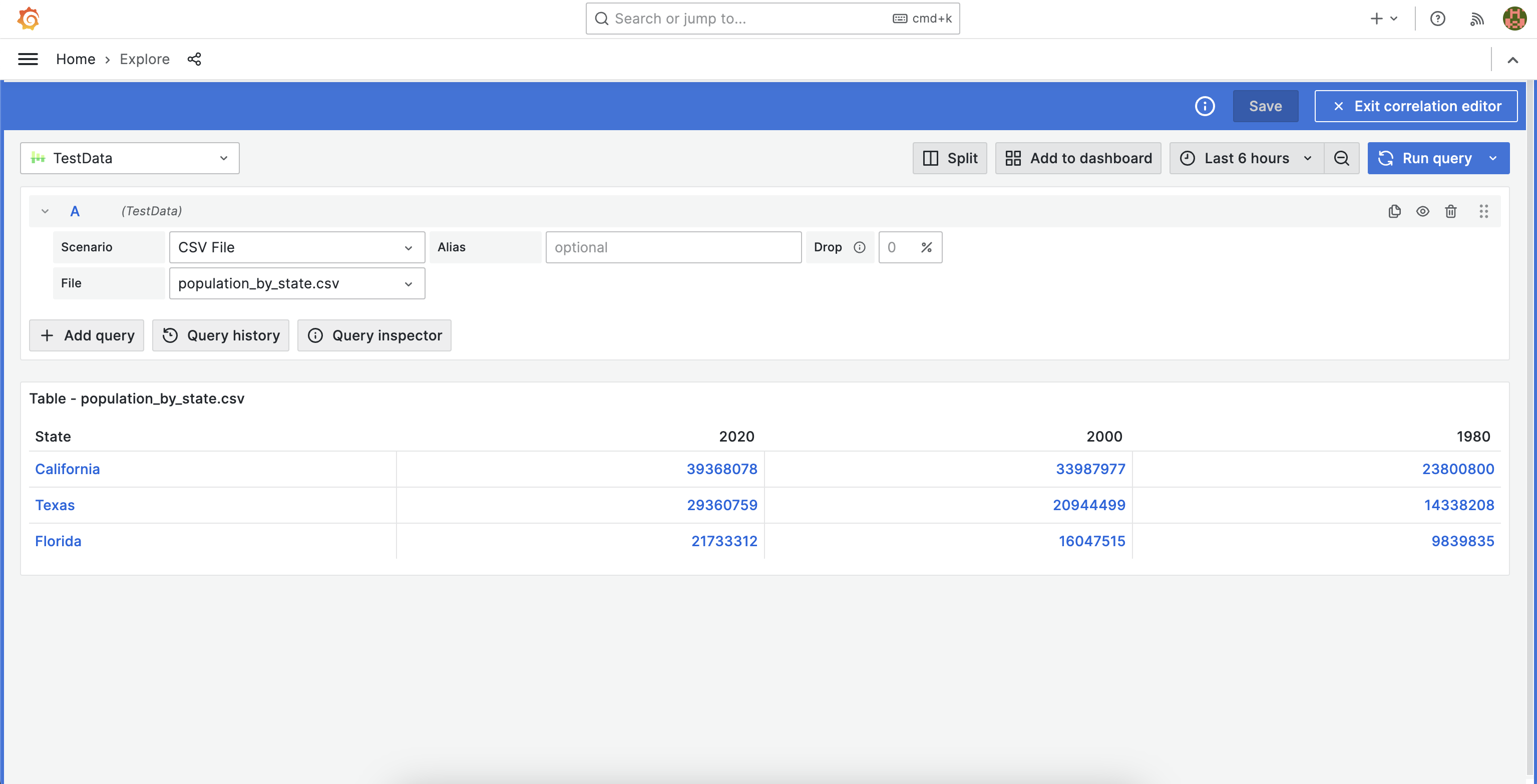

Explore is now in Correlations Editor mode, indicated by a blue border.
Select the following scenario from the scenario dropdown menu: CSV File.
Select the file, population_by_state.csv. Each cell is a link that you can click on to begin creating a new correlation.
![Selecting the source of a correlation Selecting the source of a correlation]()
Selecting the source of a correlation Click on any cell in the
Statecolumn to create a new correlation that attaches a data link to that entry. For example, select “California”.In the split view, select the same data source you selected in the left pane. The helper above the query editor contains all available variables you can use the target query. Variables contain all data fields (table columns) from the selected row.

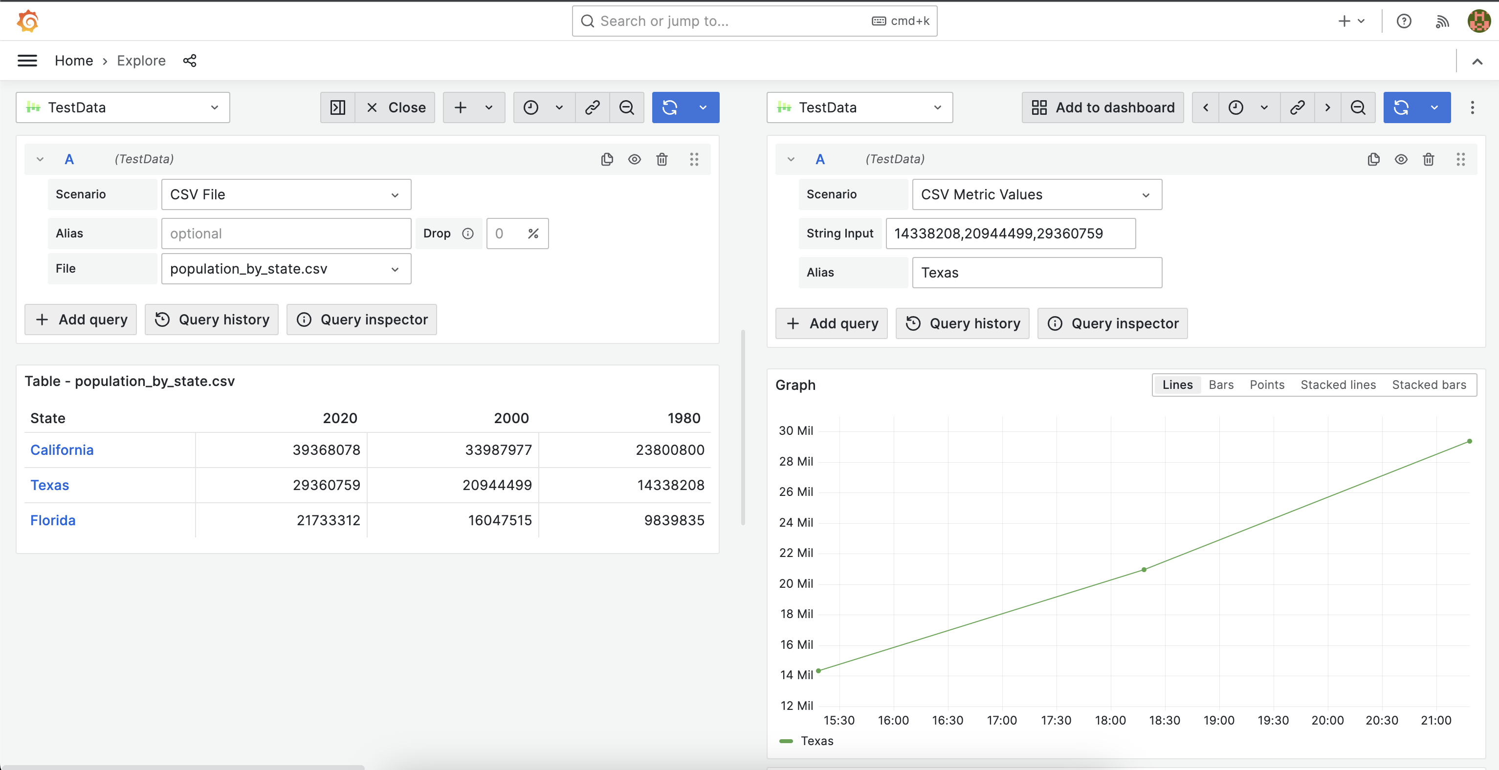

After the correlation is saved, Explore will rerun the query in the left pane. By clicking a state name, the query on the right is rerun with values from the row being inserted into the CSV, thus changing the graph. The query is rerun with updated values every time you click on a state name.
![Result of clicking on a data link Result of clicking on a data link]()
