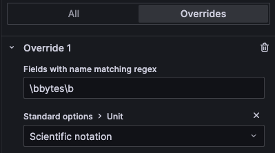

For example, you can override the default unit measurement for all fields that include the text “bytes” by adding an override using the Fields with name matching regex matcher and then the Standard options > Unit setting to the override rule:

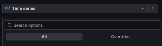

After you’ve set them, your overrides appear in both the All and Overrides tabs of the panel editor pane:
Specify fields to override with a regular expression. Properties you add to this type of rule are applied to all fields where the field name matches the regular expression. This override doesn’t rename the field; to do this, use the Rename by regex transformation.
