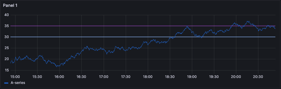

In dashboards, a threshold is a value or limit you set for a metric that’s reflected visually when it’s met or exceeded. Thresholds are one way you can conditionally style and color your visualizations based on query results.

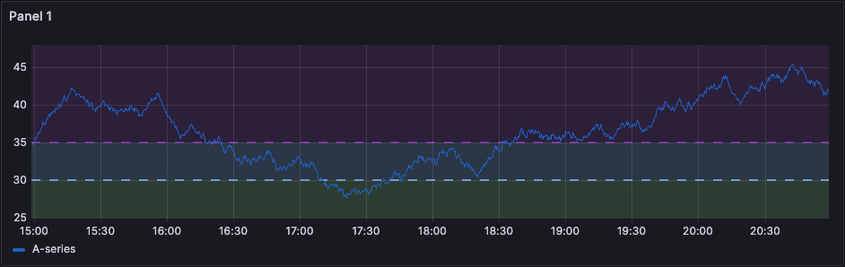

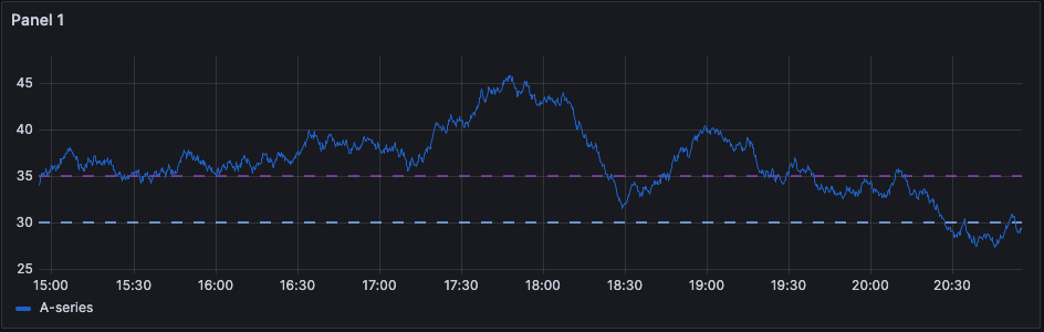

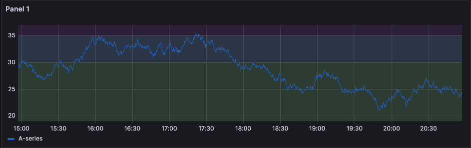

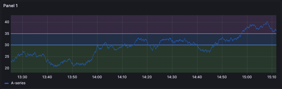

Using thresholds, you can color grid lines and regions in a time series visualization:

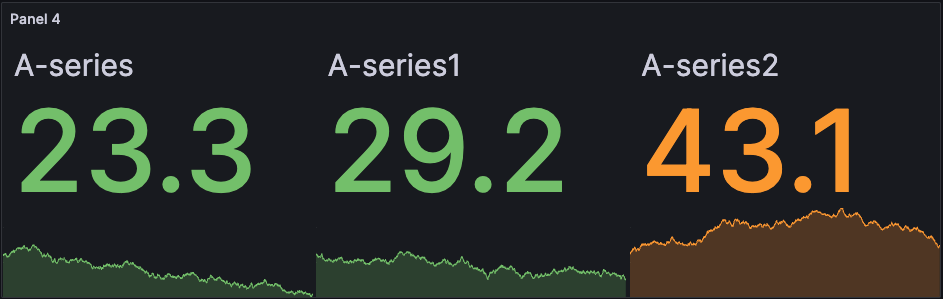

You can color the background or value text in a stat visualization:

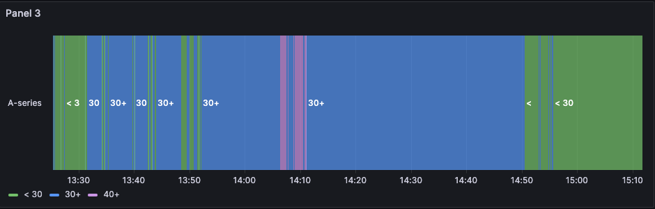

You can define regions and region colors in a state timeline:
