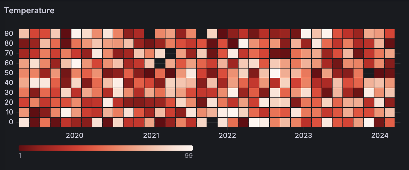

For example, if you want to understand the temperature changes for the past few years, you can use a heatmap visualization to identify trends in your data:
