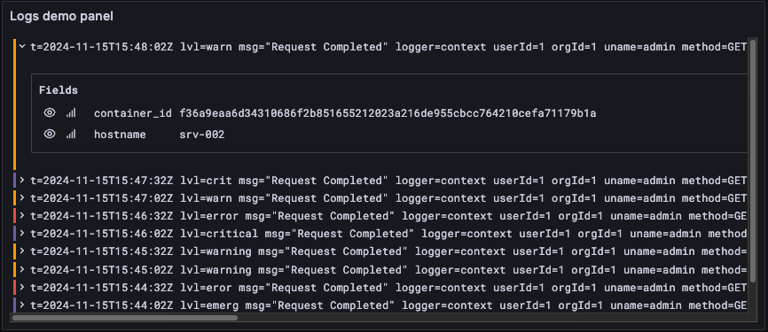

The logs visualization displays these records from data sources that support logs, such as Elastic, Influx, and Loki. The logs visualization has colored indicators of log status, as well as collapsible log events that help you analyze the information generated.
With Grafana Play, you can explore and see how it works, learning from practical examples to accelerate your development. This feature can be seen on Logs Panel.
Typically, you use logs with a graph visualization to display the log output of a related process. If you have an incident in your application or systems, such as a website disruption or code failure, you can use the logs visualization to help you figure out what went wrong, when, and even why.

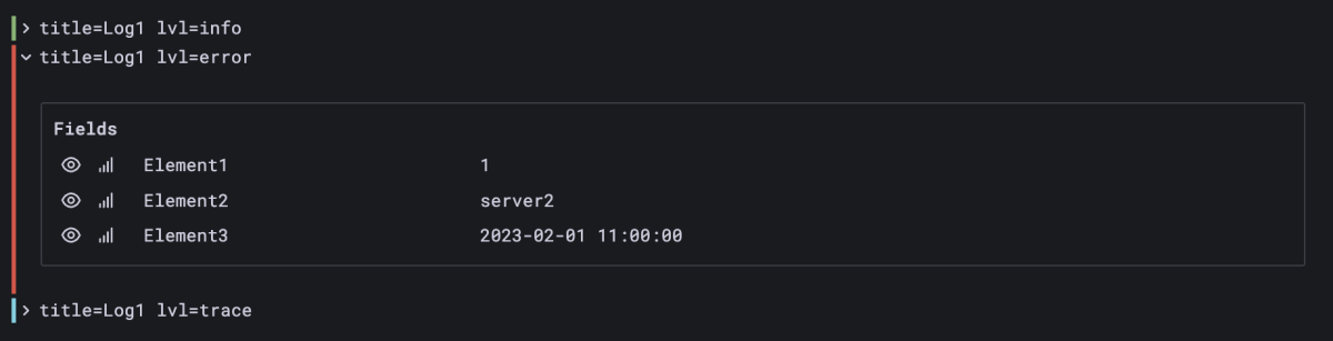

You can also build log-formatted data from other data sources as long as the first field is a time type followed by string, number, and time fields. The leading time field is used to sort and timestamp the logs and if the data contains other time-type fields, they’re included as elements of the logged record.
The second field is used as the log record title regardless of whether it’s a time, numeric, or string field. Usually the second field is a text field containing multiple string elements, but if the message level (or lvl) is present, the visualization uses the values in it to add colors to the record, as described in
Log levels integration.
Subsequent fields are collapsed inside of each log record and you can open them by clicking the expand (>) icon.
