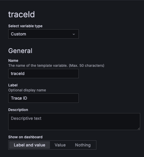

Go to the dashboard Settings and add a new variable called
traceId, of variable type Custom, giving it a label if required. Select Apply to add the variable to the dashboard.![Add a template query]()

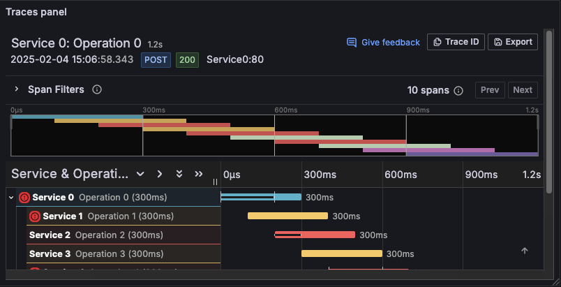

Verify that the panel works by using a valid trace ID for the data source used for the trace panel and editing the ID in the dashboard variable.
![Results of query in trace panel]()
