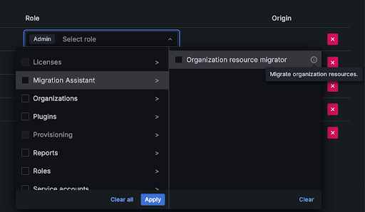

To grant other Admins access to the migration assistant in Grafana Enterprise:
Sign in to Grafana as a server administrator.
Navigate to Home > Administration > Users and access > Users in the Grafana sidebar.
Click an Admin.
In the Organizations section, click Change role.
Select Organization resource migrator from the role selector menu under Migration Assistant.
![The Organization resource migrator role in the role picker]()
Click Apply.

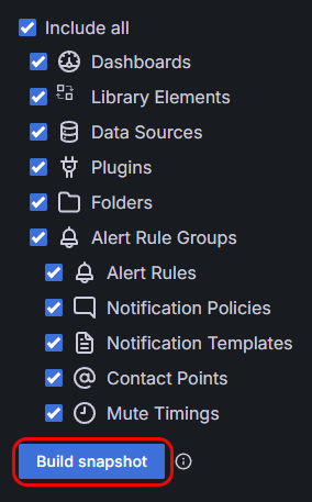

After connecting to the cloud stack, this is the empty state of the migration assistant. You need to create a snapshot of the self-managed Grafana instance to upload it to the cloud stack.
From Grafana v12.0, select the checkbox next to each resource you want to migrate to your cloud stack.
Note
Some resources can’t be uploaded to your cloud stack alone because they rely on other resources:
In Grafana v11.2 to v11.6, you can’t select specific resources to include in the snapshot, such as only dashboards. All supported resources are included by default.
Click Build snapshot

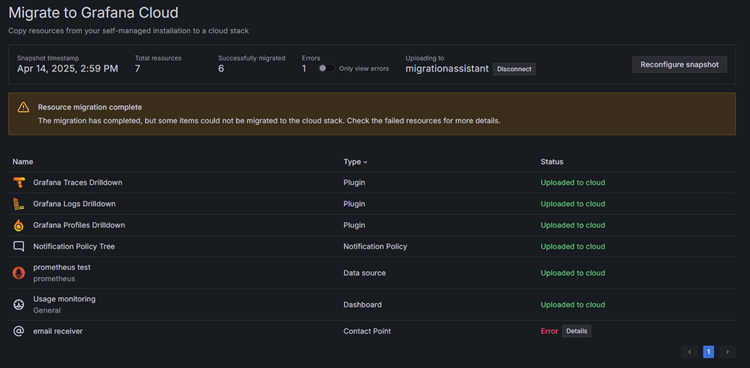

Use the assistant’s real-time progress tracking to monitor the migration. The status changes to ‘Uploaded to cloud’ for resources successfully copied to the cloud.
From Grafana v12.0, you can group and sort resources during and after the migration:
- Click Name to sort resources alphabetically.
- Click Type to group and sort by resource type.
- Click Status to group and sort by upload status (pending upload, uploaded successfully, or experienced errors).
The Snapshot information also updates to inform the user of total resources, errors, and total number of successfully migrated resources.
![An updates list of resources with snapshots built after attempting to upload them to Grafana Cloud]()
Review error details for any issues that need manual resolution.
