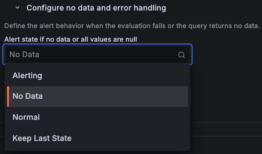

Manage No Data issues in Grafana alerts
While Prometheus provides functions like absent_over_time() to detect missing data, not all data sources — like Graphite, InfluxDB, PostgreSQL, and others — available to Grafana alerts support a similar function.
To handle this, Grafana Alerting implements a built-in No Data state logic, so you don’t need to detect missing data with absent_* queries. Instead, you can configure in the alert rule settings how alerts behave when no data is returned.
Similar to error handling, Grafana triggers a special No data alert by default and lets you control this behavior. In Configure no data and error handling, click Alert state if no data or all values are null, and choose one of the following options:
No Data (default): Triggers a new
DatasourceNoDataalert, treating No data as a specific problem.Alerting: Transition each existing alert instance into the
Alertingstate when data disappears.Normal: Ignores missing data and transitions all instances to the
Normalstate. Useful when receiving intermittent data, such as from experimental services, sporadic actions, or periodic reports.Keep Last State: Leaves the alert in its previous state until the data returns. This is common in environments where brief metric gaps happen regularly, like with flaky exporters or noisy environments.
![A screenshot of the `Configure no data handling` option in Grafana Alerting.]()
Manage DatasourceNoData notifications
