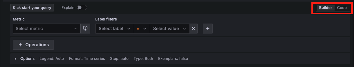

Builder mode
Builder mode helps you build queries using a visual interface. This option is best for users who have limited experience working with Prometheus and PromQL.
The following video demonstrates how to use the visual Prometheus query builder:
There’s supposed to be a video here, but for some reason there isn’t. Either we entered the id wrong (oops!), or Vimeo is down. If it’s the latter, we’d expect they’ll be back up and running soon. In the meantime, check out our blog!
Builder mode contains the following components:
Kick start your query - Click to view a list of predefined operation patterns that help you quickly build queries with multiple operations. These include:
- Rate query starters
- Histogram query starters
- Binary query starters
Click the arrow next to each to see the available options to add to your query.
- Explain - Toggle on to display a step-by-step explanation of all query components and operations.
- Builder/Code - Click the corresponding Builder or Code tab on the toolbar to select an editor mode.
If you select Builder mode you will see the following options:
- Metric - Select a metric from the drop-down. Click the icon to open Metrics explorer, where you can search for metrics by name and filter by type if your instance has a large number of metrics. Refer to Metrics explorer for more detail on using this feature.
- Label filters - Select label filters from the drop-down. Select an operator and a value.
Select desired labels and their values from the drop-down list.
When a metric is selected, the data source requests available labels and their values from the server.
Use the
+button to add a label, and thexbutton to remove a label.
Click + Operations to select from a list of operations including Aggregations, Range functions, Functions, Binary operations, Trigonometric and Time functions. You can select multiple operations. Refer to Operations for more detail.

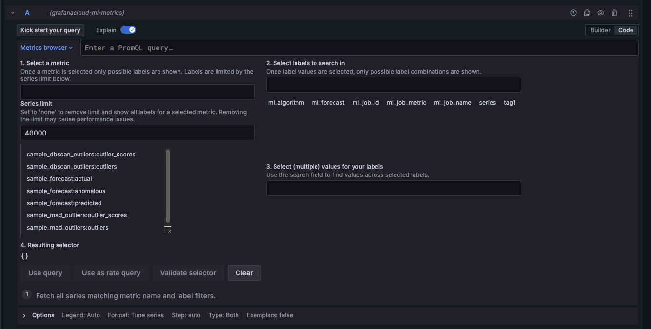

Code mode
Code mode is for the experienced Prometheus user with prior expertise in PromQL, Prometheus’ query language. The Code mode editor allows you to create queries just as you would in Prometheus. For more information about PromQL see Querying Prometheus.
The user interface (UI) also lets you select metrics, labels, filters, and operations.
You can write complex queries using the text editor with autocompletion features and syntax highlighting. Code mode’s autocomplete feature works automatically while typing. The query editor can autocomplete static functions, aggregations, keywords, and also dynamic items like metrics and labels. The autocompletion drop-down includes documentation for the suggested items where available.
It also contains a Metrics browser to further help you write queries. To open the Metrics browser, click the arrow next to Metrics browser.
Metrics browser in Code mode
The Metrics browser locates metrics and selects relevant labels to help you build basic queries.
When you click Metrics browser in Code mode, it displays all available metrics and labels.
If supported by your Prometheus instance, each metric also displays its HELP and TYPE as a tooltip.
When you select a metric under Step 1, the browser narrows down the available labels to show only the ones applicable to the metric.
You can then select one or more labels shown in Step 2.
Select one or more values in Step 3 for each label to tighten your query scope.
In Step 4, you can select Use query to run the query, Use as rate query to add the rate operation to your query ($__rate_interval), Validate selector to verify the selector is valid and show the number of series found, or Clear to clear your selections and start over.
Note
If you don’t remember the exact metric name, you can start by selecting a few labels to filter the list. This helps you find relevant label values and narrow down your options.
All lists in the Metrics browser include a search field to quickly filter metrics or labels by keyword.
In the Values section, there’s a single search field that filters across all selected labels, making it easier to find matching values. For example, if you have labels like app, job, and job_name, only one of them might contain the value you’re looking for.
When you are satisfied with your query, click Run query.
