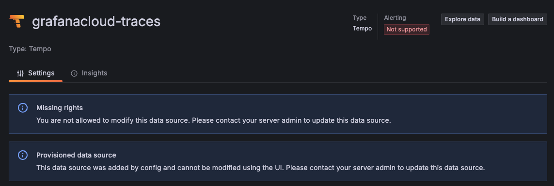

Note
You can’t modify a provisioned data source using the Tempo data source settings in Grafana Cloud.
If you want to modify any capabilities of a provisioned data source, you can clone the provisioned data source and then edit the new data source in the Grafana UI. Refer to Clone a provisioned data source for Grafana Cloud for more information.

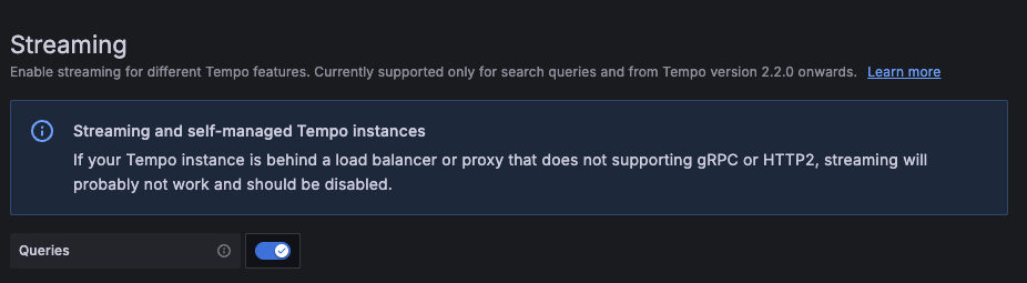

Streaming
Streaming enables TraceQL query results to be displayed as they become available. Without streaming, no results are displayed until all results have returned.
To use streaming, you need to:
Run Tempo version 2.2 or later, or Grafana Enterprise Traces (GET) version 2.2 or later, or use Grafana Cloud Traces.
Tempo must have
stream_over_http_enabled: truefor streaming to work.For more information, refer to Tempo gRPC API.
For self-managed Tempo or GET instances: If your Tempo or GET instance is behind a load balancer or proxy that doesn’t supporting gRPC or HTTP2, streaming may not work and should be deactivated.

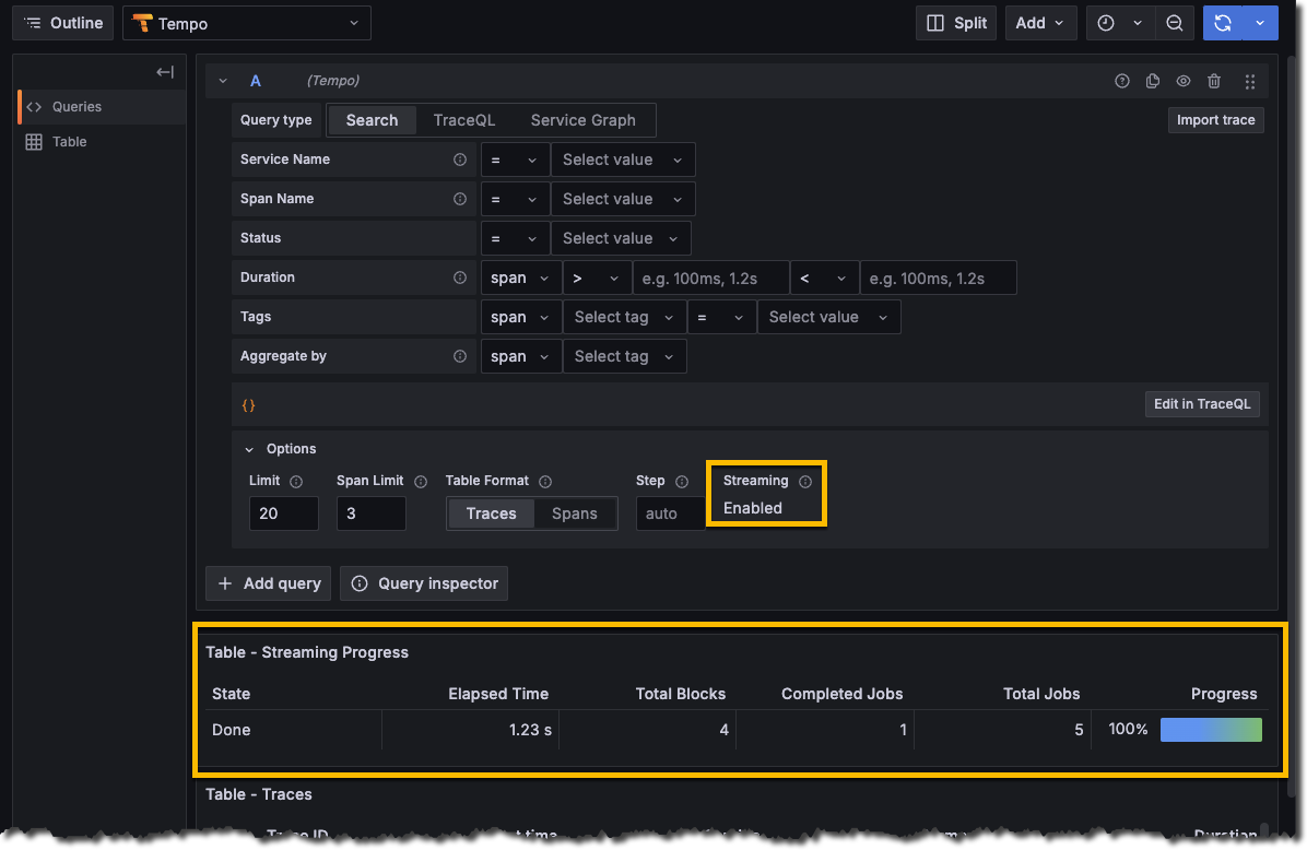

Activate streaming
Streaming is available in Grafana and Grafana Cloud. You can activate streaming by turning the Streaming toggle to on in the Tempo data source.
When streaming is active, it’s shows as Enabled in Explore. To check the status, select Explore in the menu, select your Tempo data source, and expand the Options section.

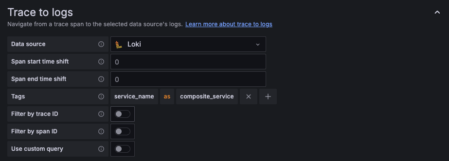

Trace to logs
The Trace to logs setting configures trace to logs that’s available when you integrate Grafana with Tempo. Trace to logs can also be used with other tracing data sources, such as Jaeger and Zipkin.
You can configure a custom query where you can use a template language to interpolate variables from the trace or span.
Configure a custom query
Select the target data source from the drop-down list.
You can also click Open advanced data source picker to see more options, including adding a data source.
Set start and end time shift. As the logs timestamps may not exactly match the timestamps of the spans in the trace it may be necessary to widen or shift the time range to find the desired logs.
Optional: Select tags to map. These tags can be used in the custom query with
${__tags}variable. This variable interpolates the mapped tags as list in an appropriate syntax for the data source. Only the tags that were present in the span are included; tags that aren’t present are omitted You can also configure a new name for the tag. This is useful in cases where the tag has dots in the name and the target data source doesn’t allow dots in labels. For example, you can remaphttp.statustohttp_status. If you don’t map any tags here, you can still use any tag in the query, for example,method="${__span.tags.method}". You can learn more about custom query variables here.Skip Filter by trace ID and Filter by span ID settings as these cannot be used with a custom query.
Switch on Use custom query.
Specify a custom query to be used to query the logs. You can use various variables to make that query relevant for current span. The link will only be shown only if all the variables are interpolated with non-empty values to prevent creating an invalid query.

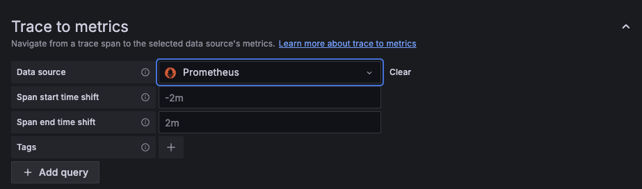

Trace to metrics
The Trace to metrics setting configures the trace to metrics feature available when integrating Grafana with Tempo.
There are two ways to configure the trace to metrics feature:
- Use a basic configuration with a default query, or
- Configure one or more custom queries where you can use a template language to interpolate variables from the trace or span.
Refer to the Trace to metrics configuration options section to learn about the available options.
Set up a simple configuration
To use a simple configuration, follow these steps:
Select a metrics data source from the Data source drop-down.
Optional: Change Span start time shift and Span end time shift. You can change one or both of these settings. The default start time shift is -2 minutes and 2 minutes for end time shift.
Optional: Choose any tags to use in the query. If left blank, the default values of
cluster,hostname,namespace,pod,service.nameandservice.namespaceare used.The tags you configure must be present in the spans attributes or resources for a trace to metrics span link to appear. You can optionally configure a new name for the tag. This is useful for example if the tag has dots in the name and the target data source doesn’t allow using dots in labels. In that case you can for example remap
service.nametoservice_name.Don’t select Add query.
Select Save and Test.

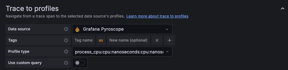

Trace to profiles
Using Trace to profiles, you can use Grafana’s ability to correlate different signals by adding the functionality to link between traces and profiles.
Trace to profiles lets you link your Grafana Pyroscope data source to tracing data. When configured, this connection lets you run queries from a trace span into the profile data using Explore. Each span links to your queries. Clicking a link runs the query in a split panel. If tags are configured, Grafana dynamically inserts the span attribute values into the query. The query runs over the time range of the (span start time - 60) to (span end time + 60 seconds).
Embedded flame graphs are also inserted into each span details section that has a linked profile. This lets you see resource consumption in a flame graph visualization for each span without having to navigate away from the current view.
There are two ways to configure the trace to profiles feature:
- Use a basic configuration with default query, or
- Configure a custom query where you can use a template language to interpolate variables from the trace or span.
To use a basic configuration, follow these steps:
In the left menu, select Connections > Data sources.
Select your configured Tempo data source from the Data source list.
Scroll down to the Traces to profiles section.
Select a Pyroscope data source in the Data source drop-down.
Optional: Add one or more tags to use in the query. If left blank, the default values of
service.nameandservice.namespaceare used.The tags you configure must be present in the spans attributes or resources for a trace-to-profiles span link to appear.
You can optionally configure a new name for the tag. This is useful if the tag has dots in the name and the target data source doesn’t allow dots in labels. In that case, you can remap
service.nametoservice_name.Select one or more profile types to use in the query. Select the drop-down and choose options from the menu.
The profile type or app must be selected for the query to be valid. Grafana doesn’t show any data if the profile type or app isn’t selected when a query runs.

Note
You can’t modify a provisioned data source using the Tempo data source settings in Grafana. Grafana displays a message for provisioned data sources.

search: trueClone a provisioned data source for Grafana Cloud
If you have a data source that is provisioned by a configuration file in Grafana Cloud, you can clone that provisioned data source and then edit the new data source in the Grafana UI.
For example, let’s say you want to edit the Trace to logs settings in your Tempo data source that is provisioned on Grafana Cloud. You’d like to enable traceID and spanID but you can’t because the data source is provisioned. By cloning the data source, you’d be able to edit these capabilities.
To clone a provisioned data source, follow these steps:
- Create a viewer Cloud Access Policy token in the Grafana Cloud Portal, making sure it has read permissions at least for the data types you are trying to clone.
- Create a new data source of the same type you want to clone.
- Copy all of the settings from the existing provisioned data source into the new data source while replacing the password with the API key you created.
The easiest way to do this is to open separate browser windows with the provisioned data source in one and the newly created data source in another.
Of course, after copying the HTTP and Auth section details, pasting the Cloud Access Policy token into the Password field, and changing any of the other options that you want, you can save and test the data source.
