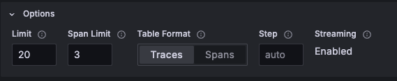

Set options for query builder and editor
The following options are available for the Search and TraceQL query types. You can modify these settings in the Options section.
Options section in the query editors
After changing any option, re-run the query to apply the updates.
Limit
Determines the maximum number of traces to return. Default value is 20.
Span Limit
Sets the maximum number of spans to return for each spanset. Default value is 3.
Table Format
Determines whether the query results table is displayed focused on Traces or Spans. Traces is the default selection. When Traces is selected, the results table starts with the trace ID. When Spans is selected, the table starts with the trace service.
Step
Defines the step for metrics queries. Use duration notation, for example, 30ms or 1m.
Streaming
Indicates if streaming is active. Streaming lets you view partial query results before the entire query completes. Activating streaming adds the Table - Streaming Progress section to the query results.

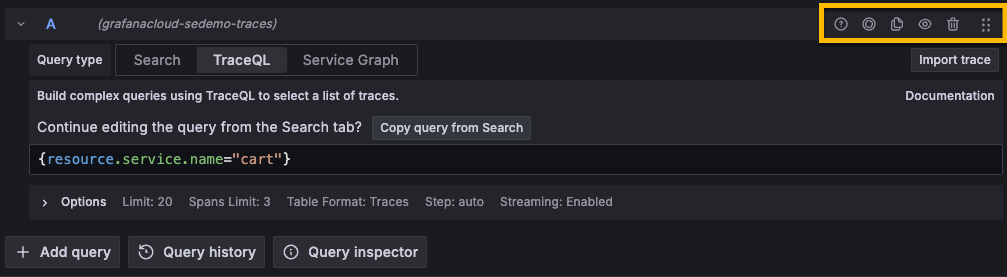

Additional query block options
Each query block has a set of icons in the right top corner.
The additional options toolbar
These icons include:
Show data source help
Displays the Tempo Cheat Sheet with links to documentation.
Create recorded query
Lets you save the current query block as a recorded query. This option is available in Grafana Cloud and Grafana Enterprise. For more information, refer to Recorded queries.
Duplicate query
Copies the current block and adds a new identical block.
Remove query
Deletes the query block.
