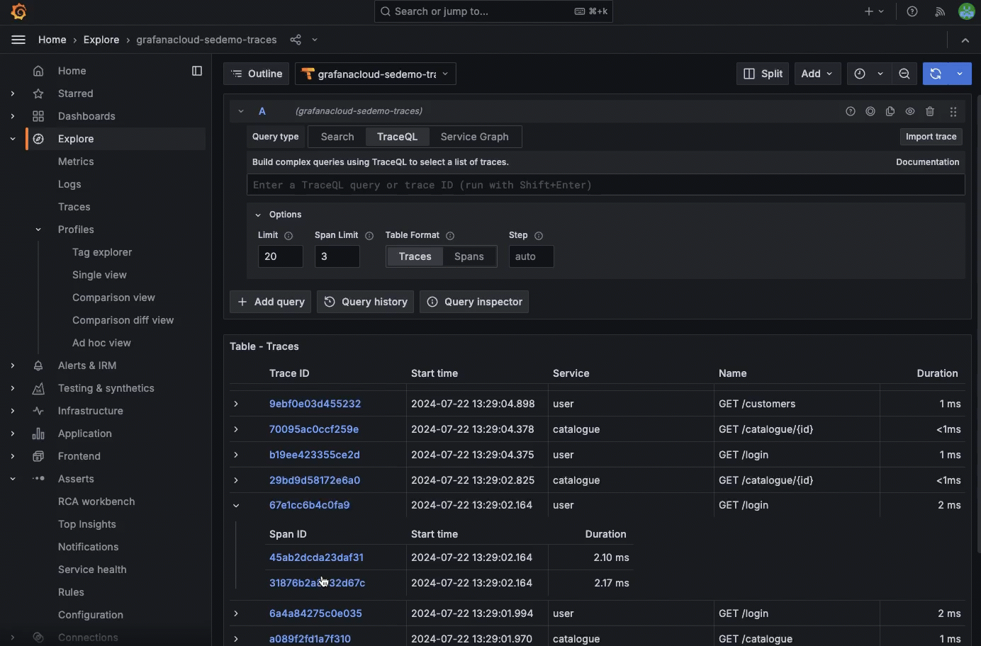

Use span filters
You can access span filters from within the trace view. You can add one or more filters. The more filters you add, the more specific data that you are filtering.
- Expand a trace to view individual spans.
- Select a span to view the span details.
- Select Span Filters to display the available filters.
Query results in the span view update as you select filters.
