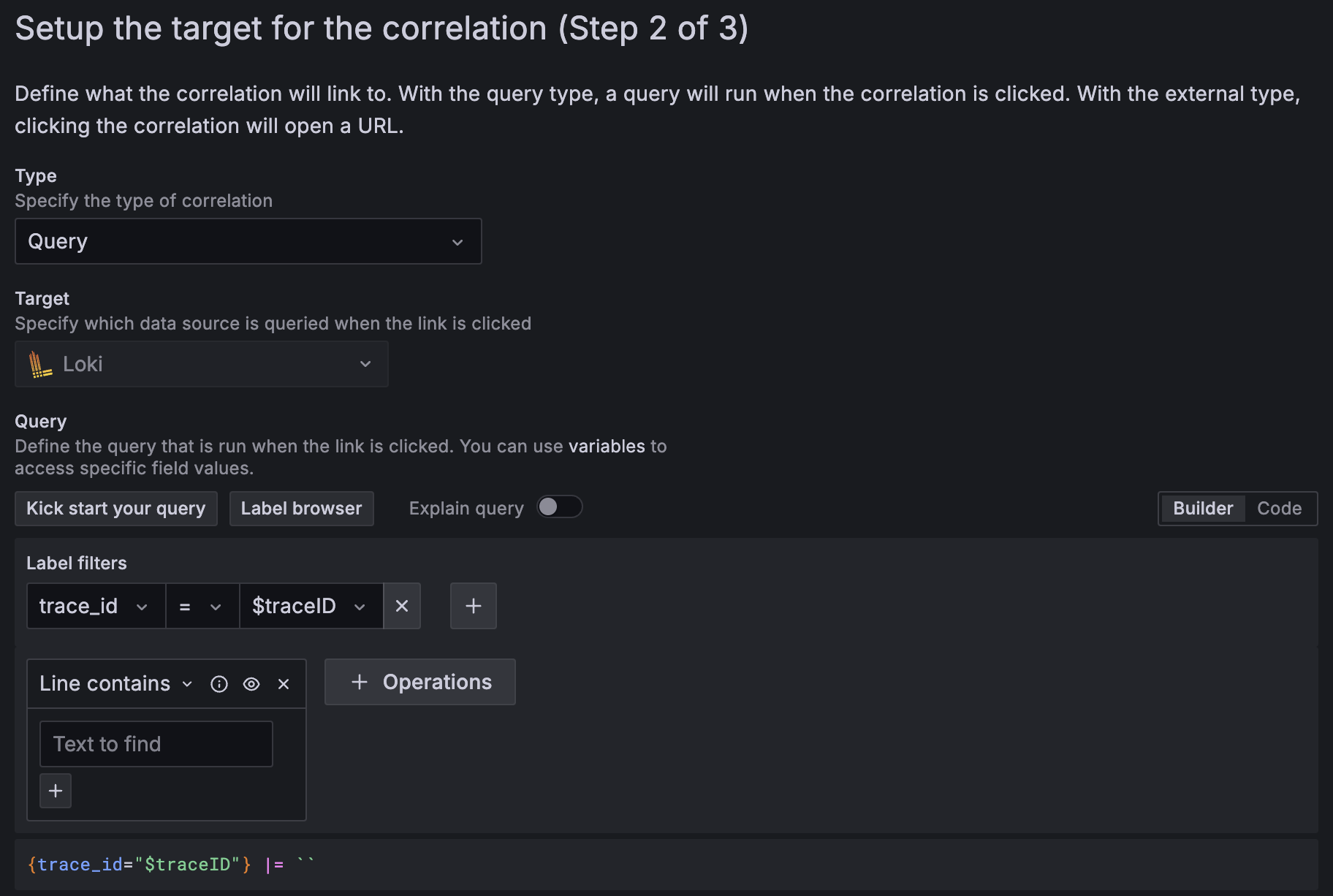

On step 2, configure the correlation target.
Select the Type drop-down list and choose Query to link to another data source or choose External for a custom URL.
For a query Target, select the target drop-down list and select the data source that should be queried when the link is clicked. Define the target query.
For an external Target, enter the External URL.
For both query and external targets, you can use the following variables based on trace data. Object variables must be parsed into a value variable with a regular expression transformation.
![Setting up a correlation for a Loki target using trace variables]()

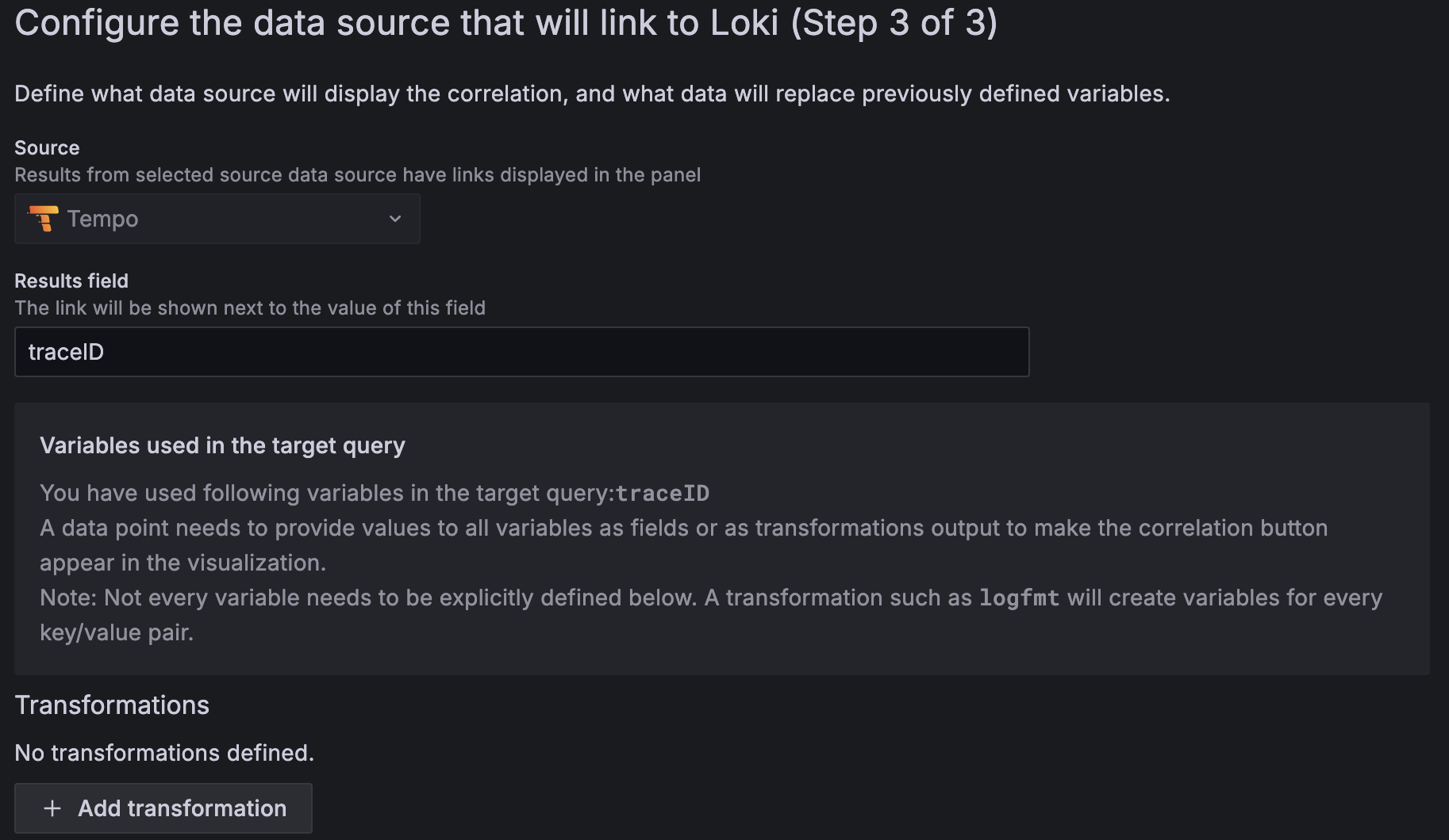

On step 3, configure the correlation data source:
Select your Tempo data source in the Source drop-down list.
Enter the trace data variable you use for the correlation in the Results field.
Optionally, add one or more Transformations to parse the trace data into additional variables. You can use these variables to configure the correlation Target.
![Setting up a correlation for a Loki data source]()

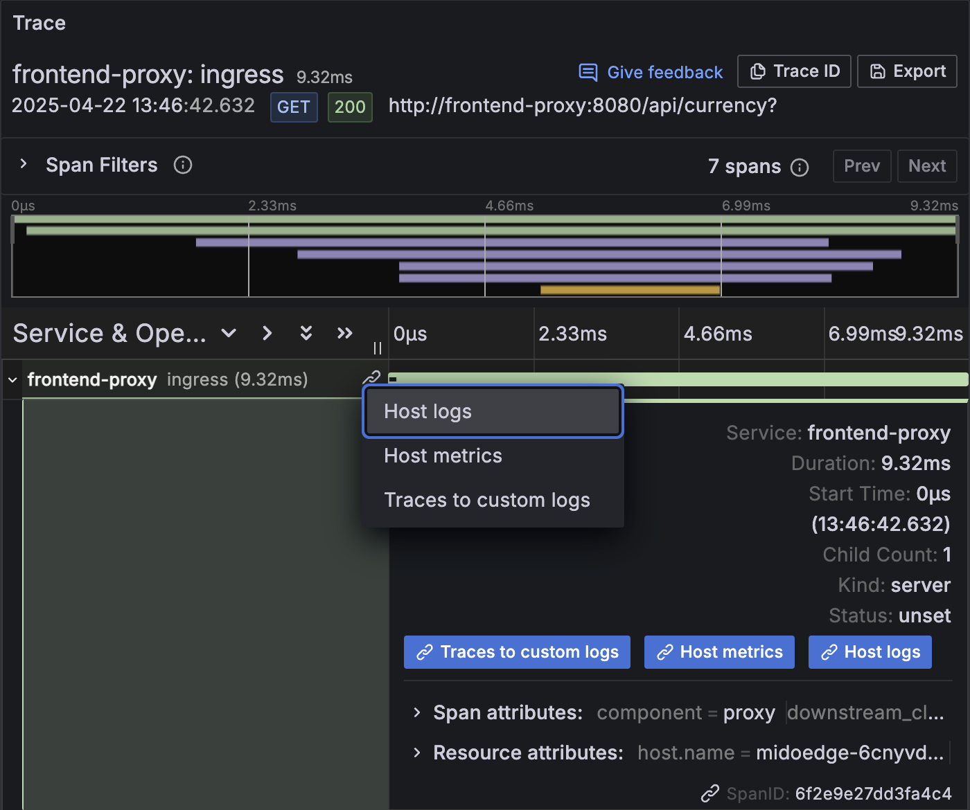

Verifying correlations in Explore
Open Explore and select your Tempo tracing source.
Run a query to load spans.
Hover over the span links menu or open the span details to reveal the correlation link buttons.
![Using correlations for a trace]()
Click a correlation link to open a split view or navigate to your target system or query.

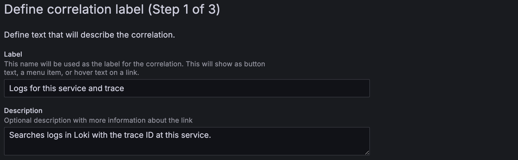

Example 1: Trace to logs by service name and trace identifier
In this example, you configure trace to logs by service name and a trace identifier.
On step 1, add a new correlation with the label Logs for this service and trace and an optional description.

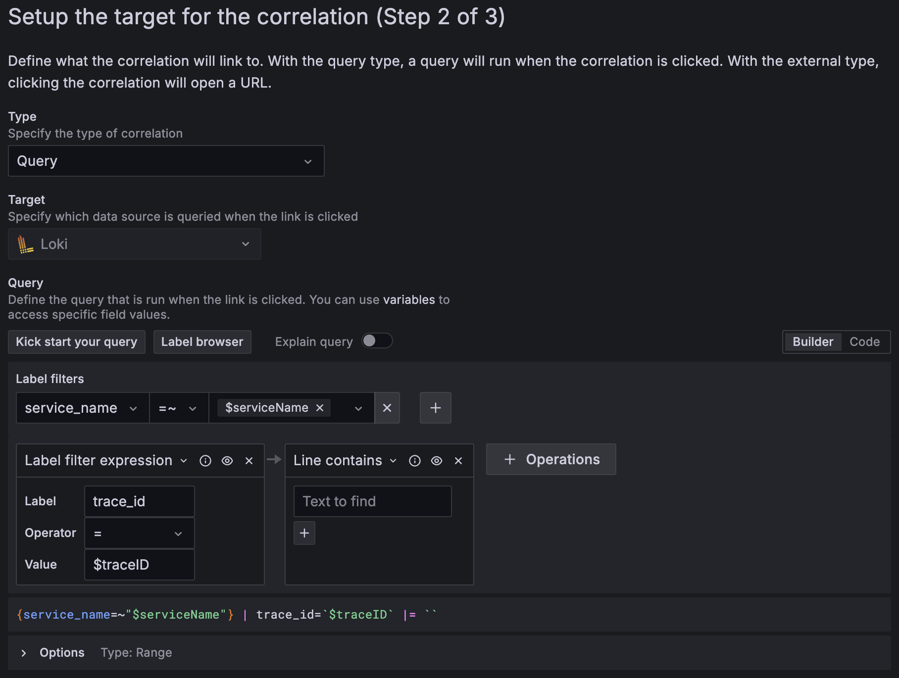

On step 2, configure the correlation target:
On step 3, configure the correlation source:

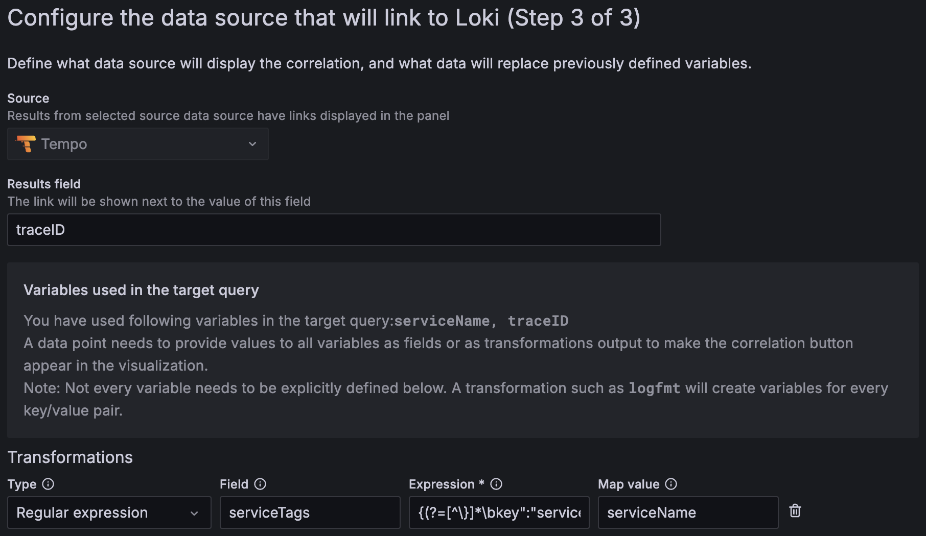

Select your Tempo data source as Source.
Use
traceIDas Results field.Add a new transformation to extract the
serviceNamefrom the spanserviceTagsusing the regular expression:{(?=[^\}]*\bkey":"service.name")[^\}]*\bvalue":"(.*?)".*}
Save the correlation.
