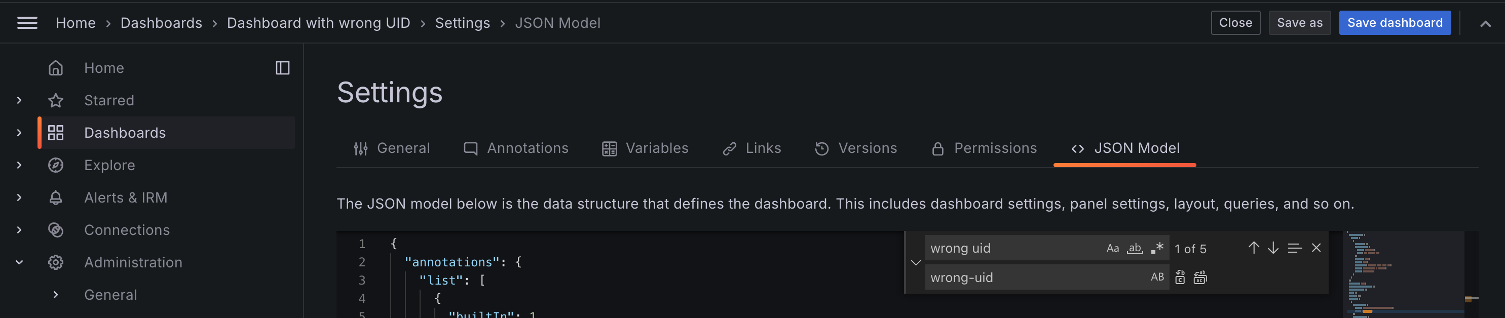

How do I update my dashboards to use the new or updated data source?
Go to the dashboard using the data source and update it by selecting the new or updated data source from the picker below your panel.
Update the dashboard’s JSON model directly using search and replace.
Navigate to dashboard json model and carefully replace all the instances of old
uidwith the newly createduid.![Updating JSON Model of a Dashboard]()
