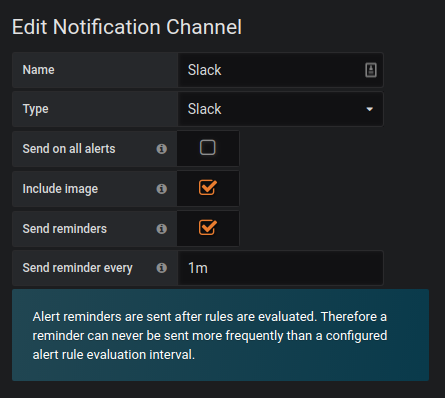

Send reminders
Only available in Grafana v5.3 and above.
When this option is checked additional notifications (reminders) will be sent for triggered alerts. You can specify how often reminders
should be sent using number of seconds (s), minutes (m) or hours (h), for example 30s, 3m, 5m or 1h etc.
Important: Alert reminders are sent after rules are evaluated. Therefore a reminder can never be sent more frequently than a configured alert rule evaluation interval.

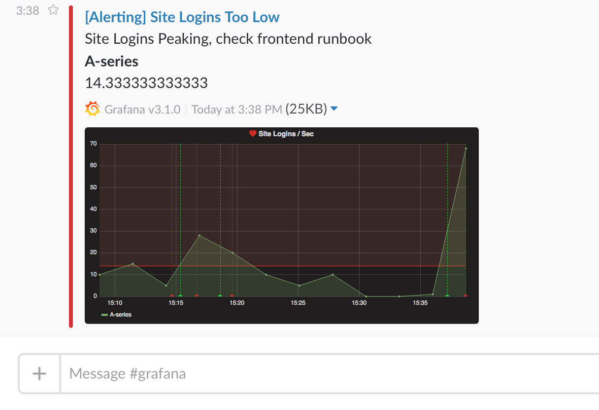

Slack
To set up slack you need to configure an incoming webhook url at slack. You can follow their guide on how to do that here. If you want to include screenshots of the firing alerts in the Slack messages you have to configure either the external image destination in Grafana, or a bot integration via Slack Apps. Follow Slack’s guide to set up a bot integration and use the token provided (https://api.slack.com/bot-users), which starts with “xoxb”.
If you are using the token for a slack bot, then you have to invite the bot to the channel you want to send notifications and add the channel to the recipient field.
