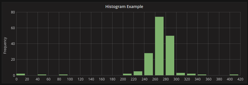

Example Histogram:
The above histogram shows us that most value distribution of a couple of time series. We can easily see that most values land between 240-300 with a peak between 260-280. Histograms just look at value distributions over specific time range. So you cannot see any trend or changes in the distribution over time, this is where heatmaps become useful.

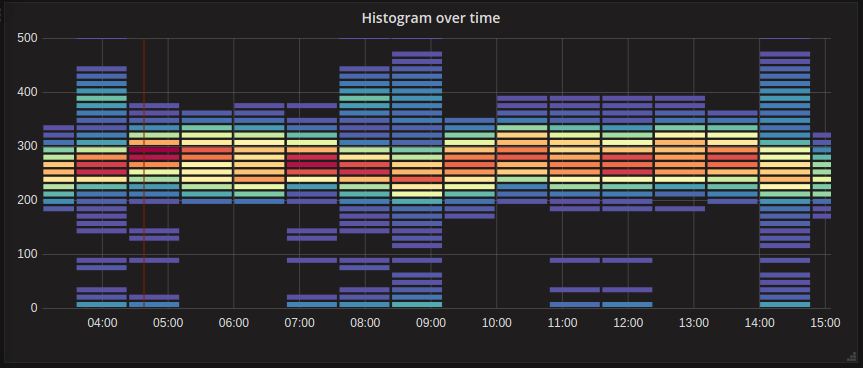

Example:
Here we can clearly see what values are more common and how they trend over time.

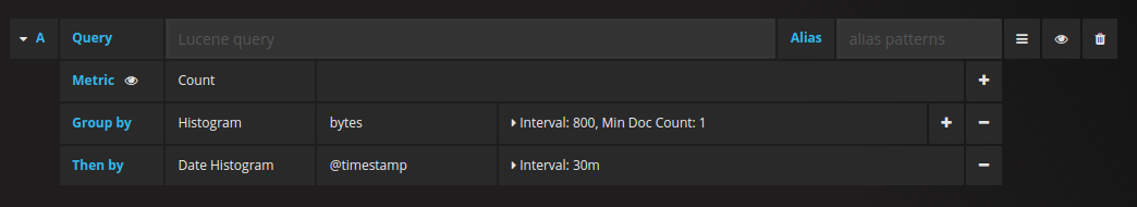

With Elasticsearch you control the size of the buckets using the Histogram interval (Y-Axis) and the Date Histogram interval (X-axis).

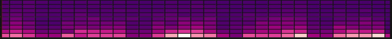

The color spectrum controls the mapping between value count (in each bucket) and the color assigned to each bucket. The left most color on the spectrum represents the minimum count and the color on the right most side represents the maximum count. Some color schemes are automatically inverted when using the light theme.
You can also change the color mode to Opacity. In this case, the color will not change but the amount of opacity will
change with the bucket count.
