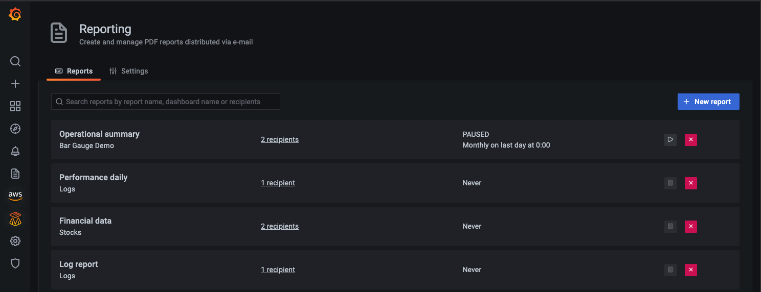

Currently only Organisation Admins can create reports. To get to report click on the reports icon in the side menu. This will allow you to list, create and update your reports.
