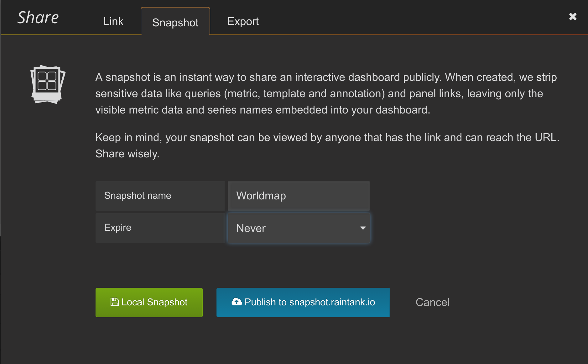

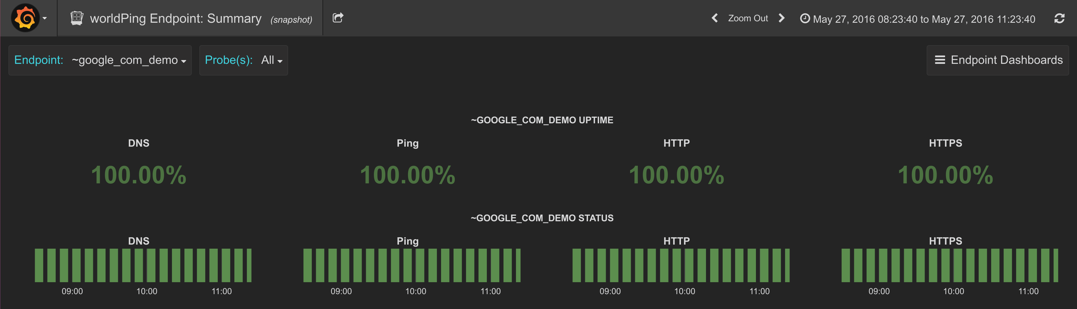

Grafana has this great feature where you can save a snapshot of your dashboard. Instead of sending a screenshot of a dashboard to someone, you can send them a working, interactive Grafana dashboard with the snapshot data embedded inside it. The snapshot can be saved on your Grafana server and is available to all your co-workers. Raintank also hosts a snapshot server if you want to send the snapshot to someone who does not have access to your Grafana server.
This all works because Grafana saves a snapshot of the current data in the dashboard json instead of fetching the data from a data source. However, if you are building a custom panel plugin then this will not work straight out of the box. You will need to make some small (and easy!) changes first.
