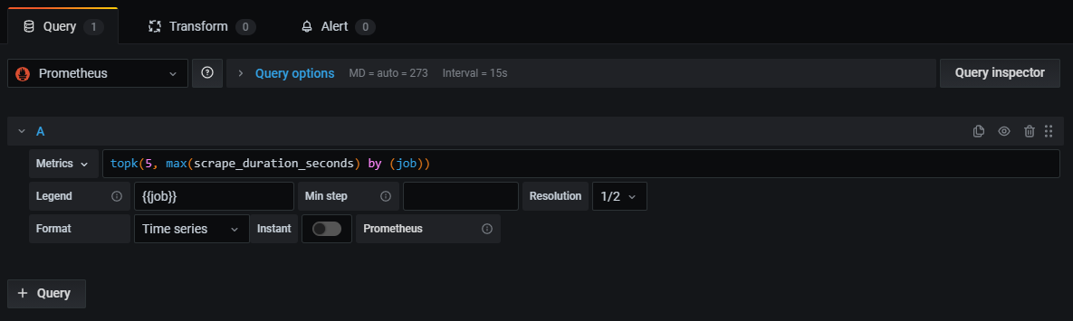

Query editor list
In the UI, queries are organized in collapsible query rows. Each query row contains a query editor and is identified with a letter (A, B, C, and so on).
