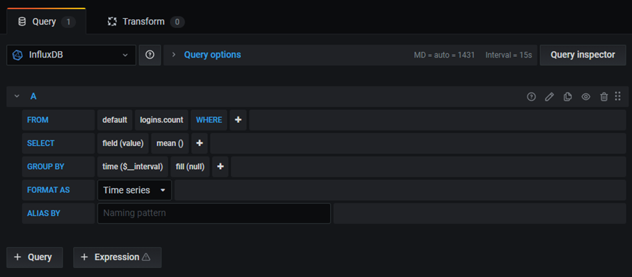

InfluxQL query editor
Enter edit mode by clicking the panel title and clicking Edit. The editor allows you to select metrics and tags.
Filter data (WHERE)
To add a tag filter, click the plus icon to the right of the WHERE condition. You can remove tag filters by clicking on the tag key and then selecting --remove tag filter--.
Regex matching
You can type in regex patterns for metric names or tag filter values. Be sure to wrap the regex pattern in forward slashes (/). Grafana automatically adjusts the filter tag condition to use the InfluxDB regex match condition operator (=~).
Field and Aggregation functions
In the SELECT row you can specify what fields and functions you want to use. If you have a group by time you need an aggregation function. Some functions like derivative require an aggregation function. The editor tries to simplify and unify this part of the query. For example:
The above generates the following InfluxDB SELECT clause:
SQL
SELECT derivative(mean("value"), 10s) /10 AS "REQ/s" FROM ....
Select multiple fields
Use the plus button and select Field > field to add another SELECT clause. You can also specify an asterix * to select all fields.
Group By
To group by a tag, click the plus icon at the end of the GROUP BY row. Pick a tag from the dropdown that appears. You can remove the “Group By” by clicking on the tag and then click on the x icon.
Text Editor Mode (RAW)
You can switch to raw query mode by clicking hamburger icon and then Switch editor mode.
If you use Raw Query be sure your query at minimum have WHERE $timeFilter. Also, always have a group by time and an aggregation function, otherwise InfluxDB can easily return hundreds of thousands of data points that will hang the browser.
