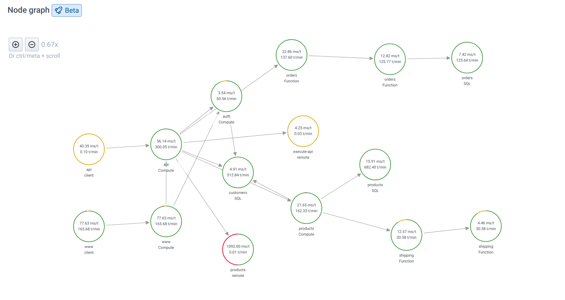

The Node graph can visualize directed graphs or networks. It uses directed force layout to effectively position the nodes so it can help with displaying complex infrastructure maps, hierarchies or execution diagrams.

The Node graph visualization consists of nodes and edges.
- A node is displayed as a circle. A node might represent an application, a service, or anything else that is relevant from an application perspective.
- An edge is displayed as a line that connects two nodes. The connection might be a request, an execution, or some other relationship between the two nodes.

Usually, nodes show two statistical values inside the node and two identifiers just below the node, usually name and type. Nodes can also show another set of values as a color circle around the node, with sections of different color represents different values that should add up to 1.
For example you can have percentage of errors represented by red portion of the circle. Additional details can be displayed in a context menu when which is displayed when you click on the node. There also can be additional links in the context menu that can target either other parts of Grafana or any external link.

Edges can also show statistics when you hover over the edge. Similar to nodes, you can open a context menu with additional details and links by clicking on the edge.
