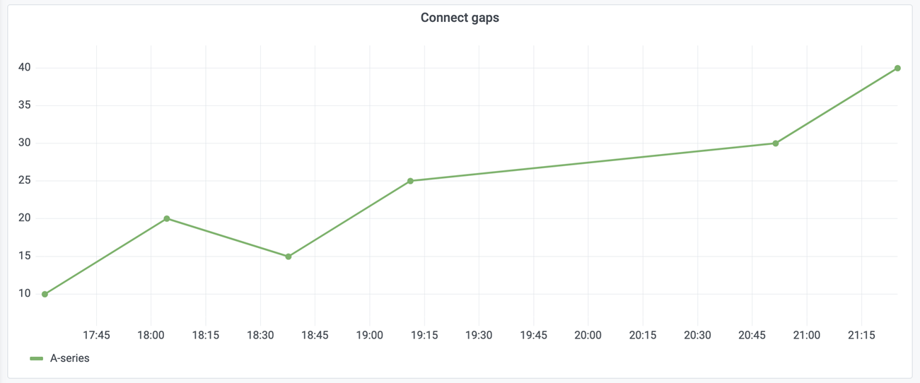

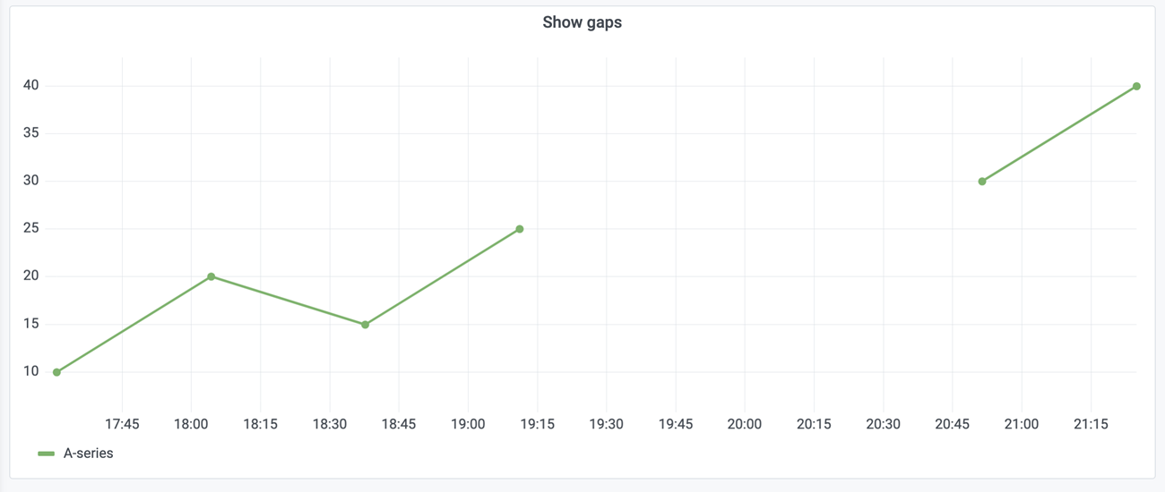

Null values
Choose how null values (gaps in the data) are displayed on the graph.
Gaps
If there is a gap in the series, the line in the graph will be broken and show the gap.
Connected
If there is a gap in the series, the line will skip the gap and connect to the next non-null value.
