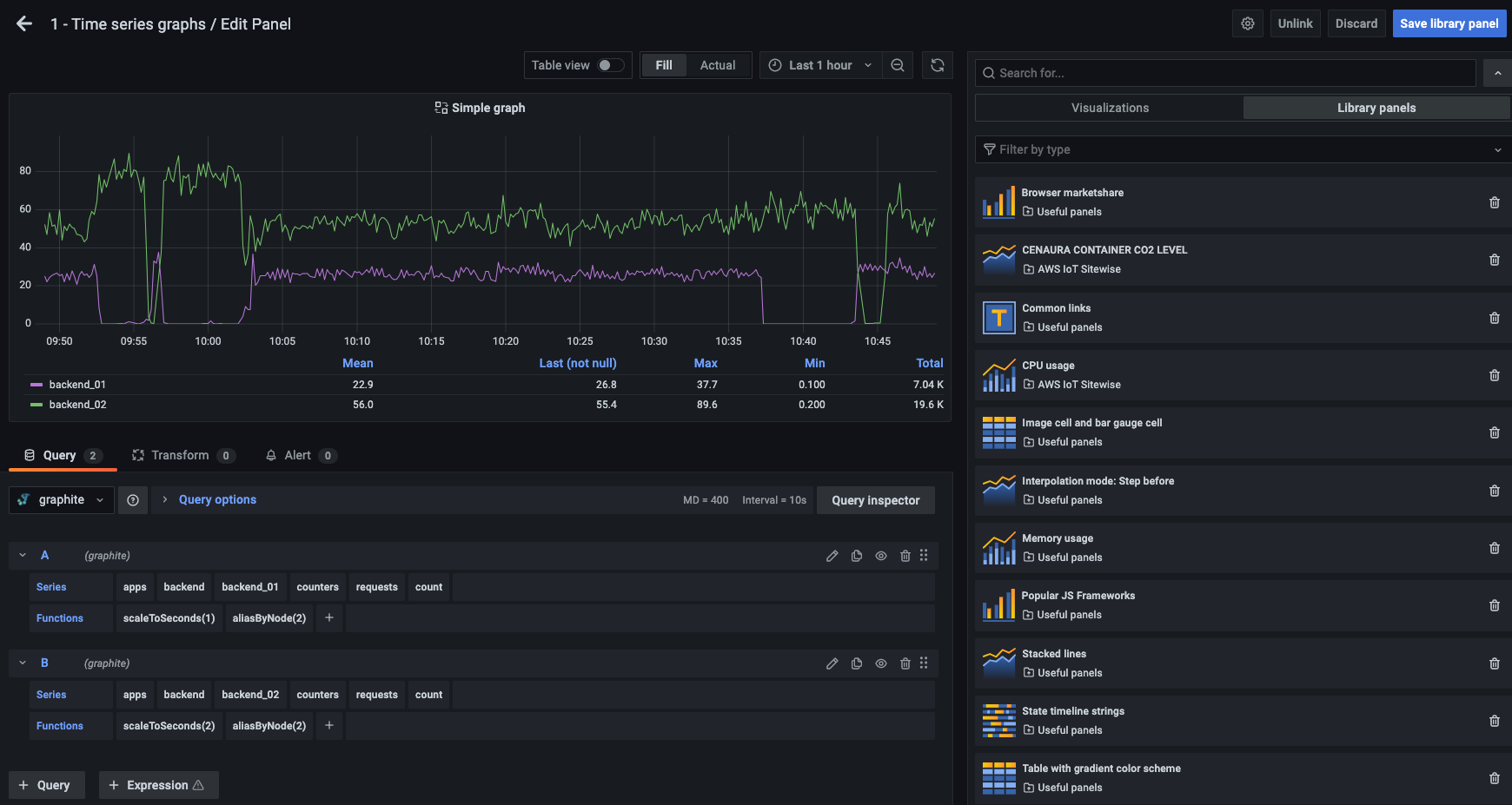

- Hover over the + option on the left menu, then select Create from the drop down options. The Add panel dialog opens.
![Screenshot of the edit panel Screenshot of the edit panel]()
Screenshot of the edit panel - Click the Add a panel from the panel library option. You will see a list of your library panels.
- Filter the list or search to find the panel you want to add.
- Click your desired panel and add it to the dashboard.

- Hover over the Dashboard option on the left menu, then click Library panels. You can see a list of previously defined library panels.
Screenshot of the edit panel - Search for a specific library panel if you know its name. You can also filter the panels by folder or type.
