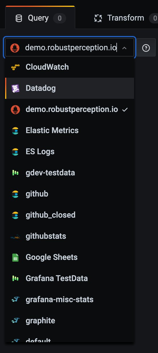

Data source selector
The data source selector is a drop-down list. Click it to select a data source you have added. When you create a panel, Grafana automatically selects your default data source. For more information about adding data sources, refer to Add a data source.
In addition to the data sources that you have configured in your Grafana, there are three special data sources available:
- Grafana - A built-in data source that generates random walk data. Useful for testing visualizations and running experiments.
- Mixed - Select this to query multiple data sources in the same panel. When this data source is selected, Grafana allows you to select a data source for every new query that you add.
- The first query will use the data source that was selected before you selected Mixed.
- You cannot change an existing query to use the Mixed Data Source.
- Dashboard - Select this to use a result set from another panel in the same dashboard.
