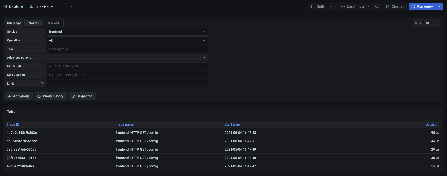

Query traces
You can query and display traces from Jaeger via Explore.
Screenshot of the Jaeger query editor

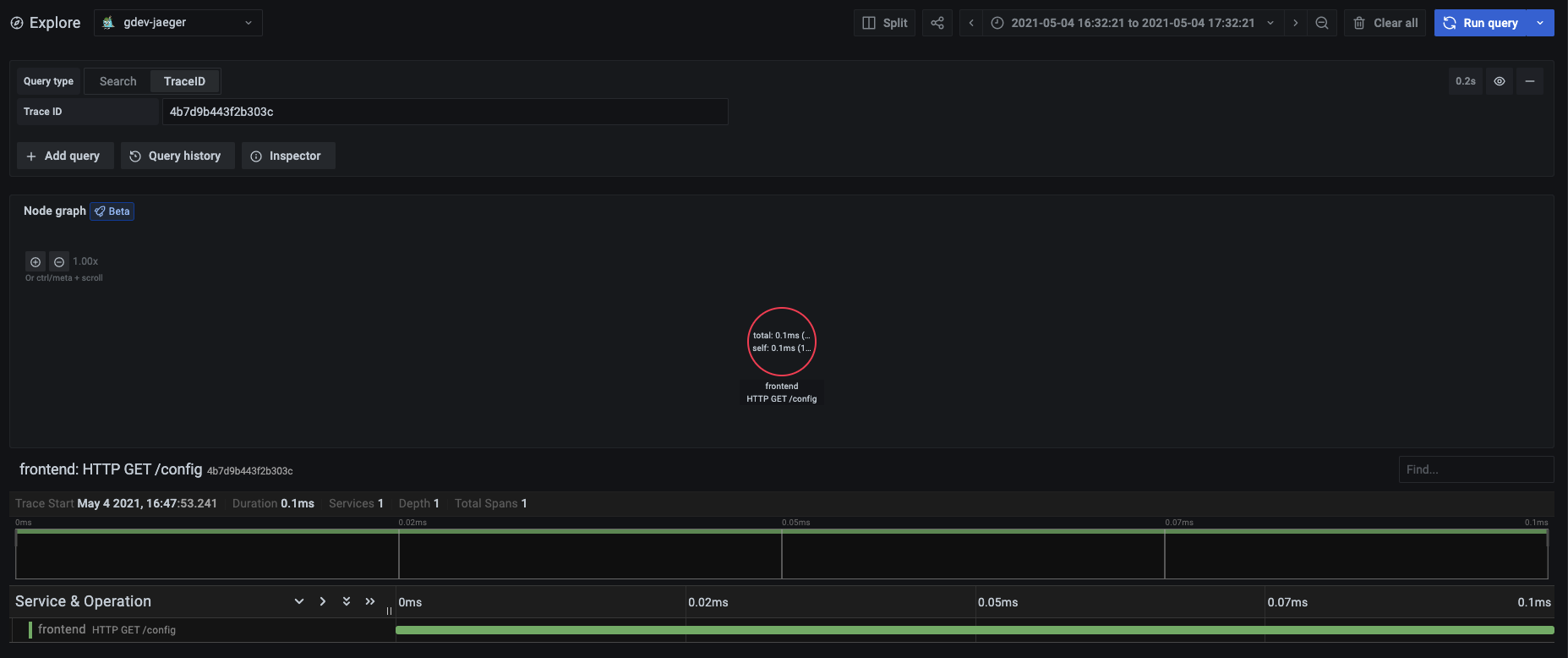

You can query by trace ID or use the search form to find traces. To query by trace ID, select the TraceID from the Query type selector and insert the ID into the text input.
Screenshot of the Jaeger query editor with trace ID selected
To perform a search, set the query type selector to Search, then use the following fields to find traces:
  • Service - Returns a list of services.
  • Operation - Field gets populated once you select a service. It then lists the operations related to the selected service. Select All option to query all operations.
  • Tags - Use values in the logfmt format. For example error=true db.statement="select * from User".
  • Min Duration - Filter all traces with a duration higher than the set value. Possible values are 1.2s, 100ms, 500us.
  • Max Duration - Filter all traces with a duration lower than the set value. Possible values are 1.2s, 100ms, 500us.
  • Limit - Limits the number of traces returned.
