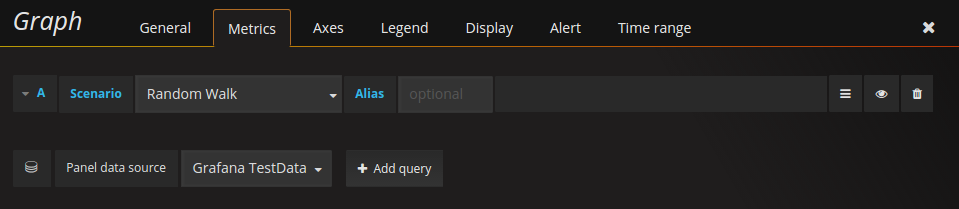

Create mock data.
Once TestData DB is enabled, you can use it as a data source in any metric panel.

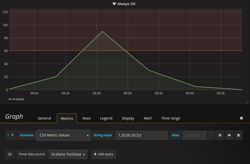

CSV
The comma separated values scenario is the most powerful one since it lets you create any kind of graph you like.
Once you provided the numbers, TestData DB distributes them evenly based on the time range of your query.
