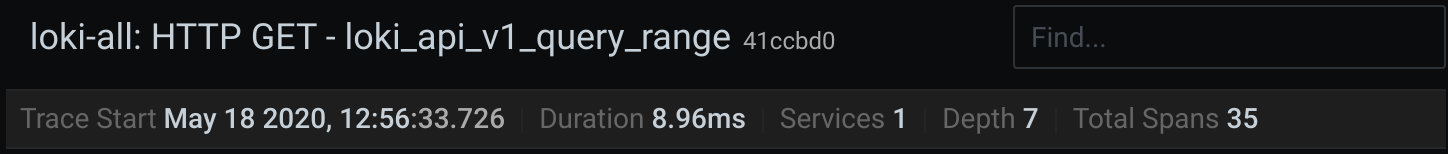

Header
- Header title: Shows the name of the root span and trace ID.
- Search: Highlights spans containing the searched text.
- Metadata: Various metadata about the trace.

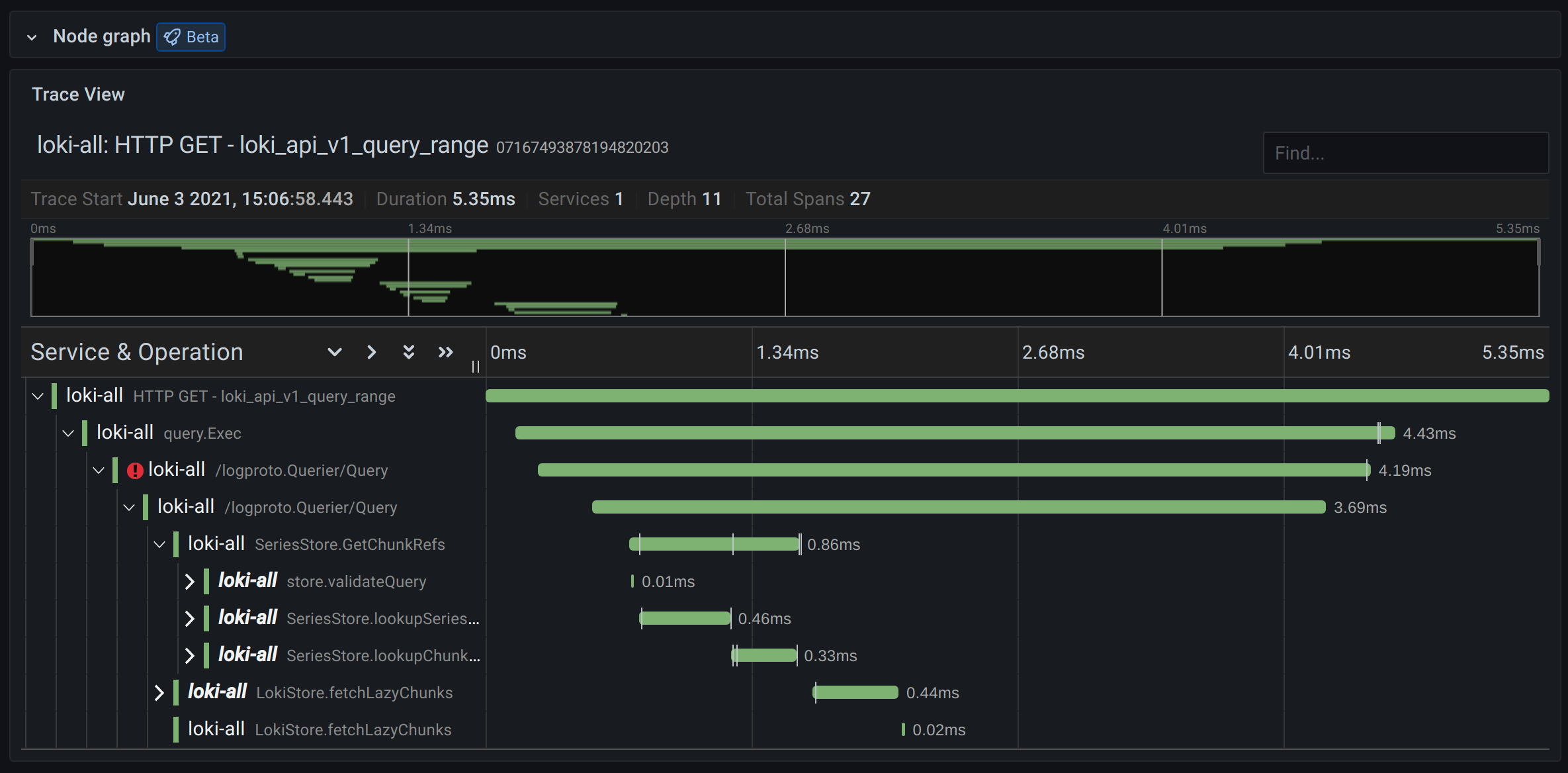

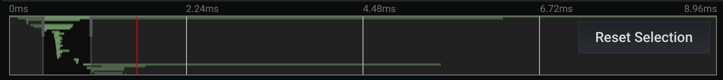

Minimap
Shows condensed view or the trace timeline. Drag your mouse over the minimap to zoom into smaller time range. Zooming will also update the main timeline, so it is easy to see shorter spans. Hovering over the minimap, when zoomed, will show Reset Selection button which resets the zoom.

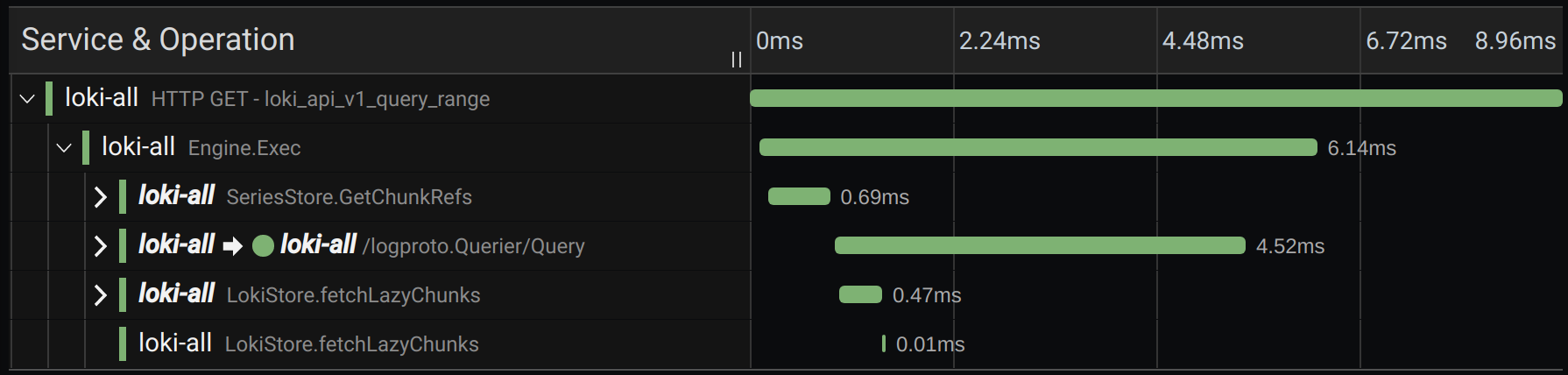

Timeline
Shows list of spans within the trace. Each span row consists of these components:
- Expand children button: Expands or collapses all the children spans of selected span.
- Service name: Name of the service logged the span.
- Operation name: Name of the operation that this span represents.
- Span duration bar: Visual representation of the operation duration within the trace.
Clicking anywhere on the span row shows span details.

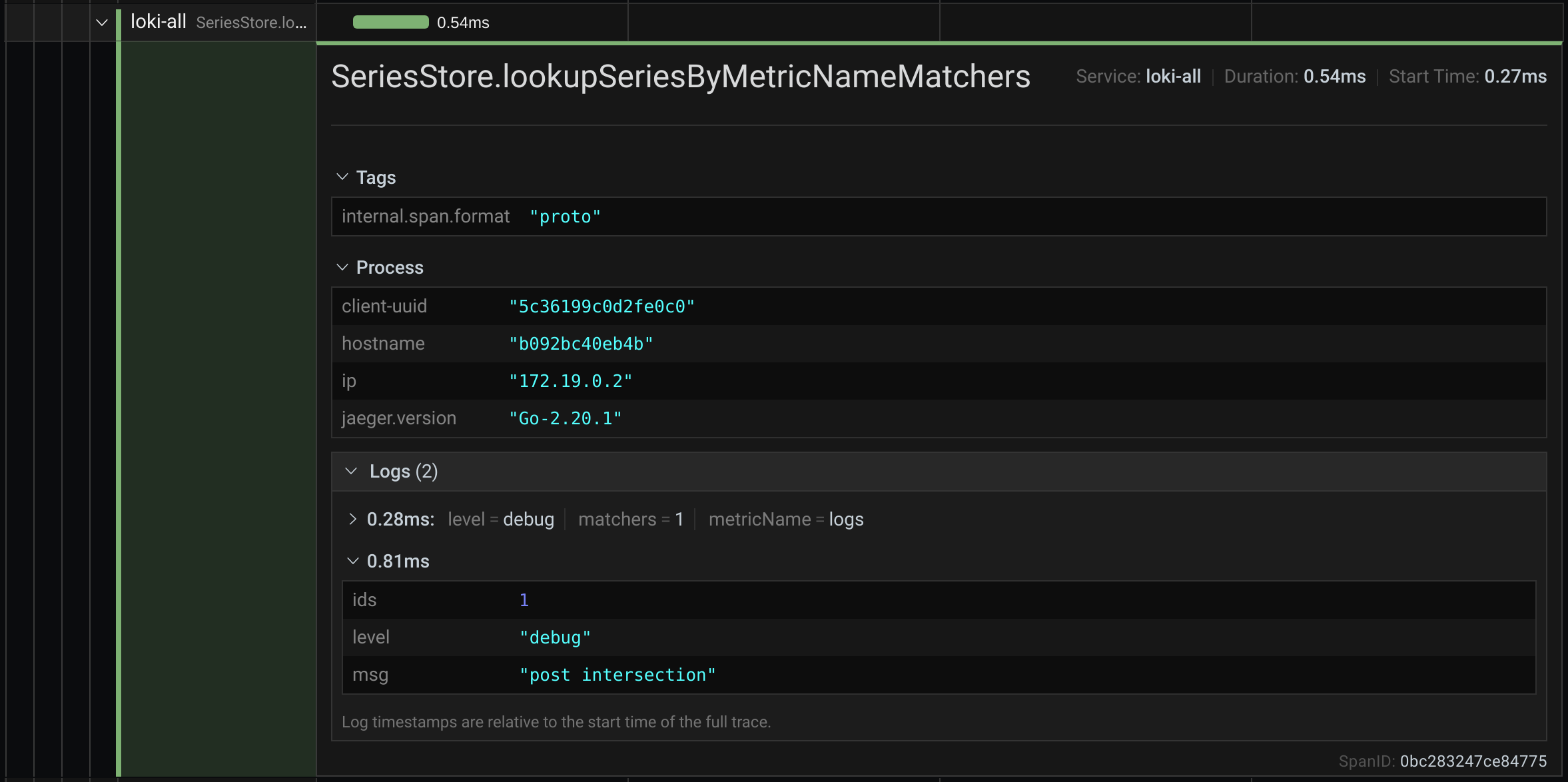

Span details
- Operation name
- Span metadata
- Tags: Any tags associated with this span.
- Process metadata: Metadata about the process that logged this span.
- Logs: List of logs logged by this span and associated key values. In case of Zipkin logs section shows Zipkin annotations.

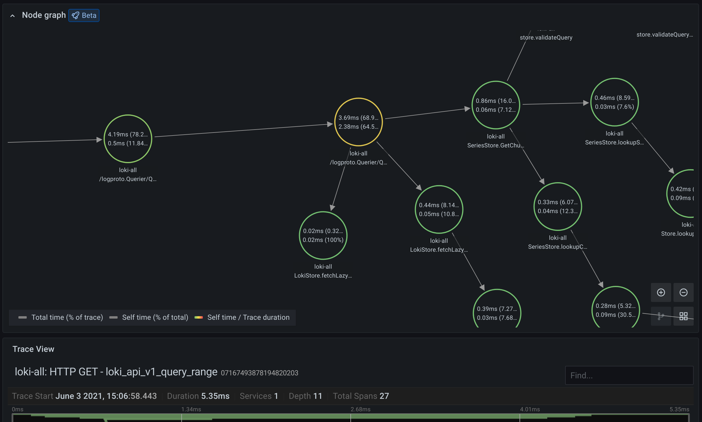

Node graph
You can optionally expand the node graph for the displayed trace. Depending on the data source, this can show spans of the trace as nodes in the graph, or as some additional context like service graph based on the current trace.

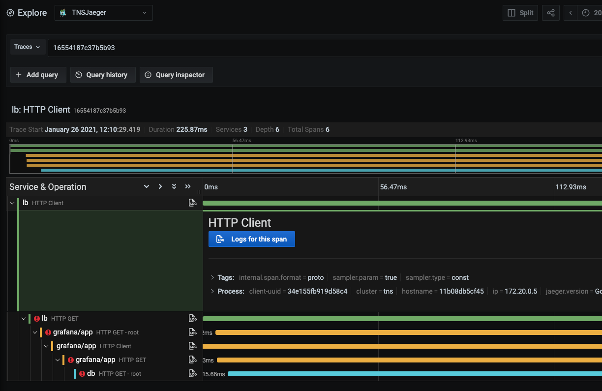

Trace to logs
Note: Available in Grafana 7.4 and later versions.
You can navigate from a span in a trace view directly to logs relevant for that span. This is available for Tempo, Jaeger, and Zipkin data sources at this moment. Refer to their relevant documentation for instructions on how to configure this feature.
Click the document icon to open a split view in Explore with the configured data source and query relevant logs for the span.
