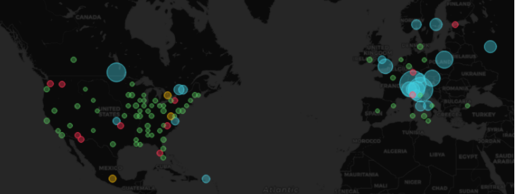

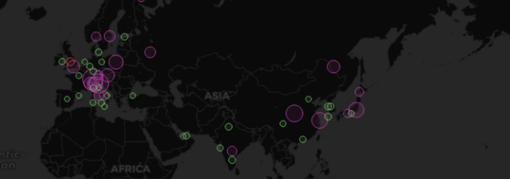

- Marker renders a marker at each data point.

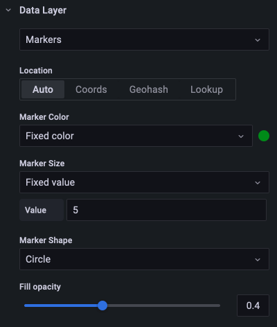

Markers layer
The markers layer allows you to display data points as different marker shapes such as circles, squares, triangles, stars, and more.
- Marker Color configures the color of the marker. The default
Single colorkeeps all points a single color. There is an alternate option to have multiple colors depending on the data point values and the threshold set at theThresholdssection. - Marker Size configures the size of the marker. Default is
Fixed size, making all marker size the same regardless of the data points. However, there is also an option to scale the circles to the corresponding data points.MinandMaxmarker size has to be set such that the Marker layer can scale within this range. - Marker Shape allows you to choose the shape, icon, or graphic to aid in providing additional visual context to your data. Choose from assets that are included with Grafana such as simple shapes or the Unicon library. You can also specify a URL containing an image asset. The image must be a scalable vector graphic (SVG).
- Fill opacity configures the transparency of each marker.

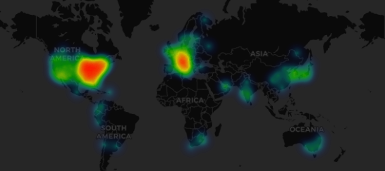

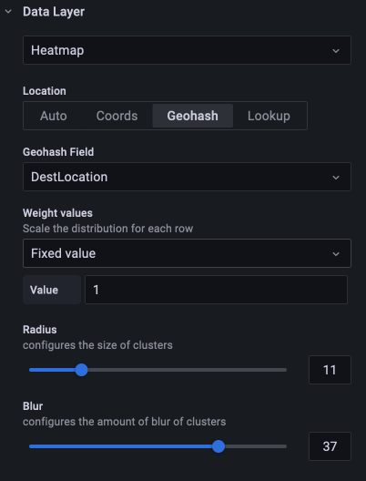

Heatmap layer
The heatmap layer clusters various data points to visualize locations with different densities. To add a heatmap layer:
Click on the drop-down menu under Data Layer and choose Heatmap.
Similar to Markers, you are prompted with various options to determine which data points to visualize and how.
- Weight values configure the intensity of the heatmap clusters.
Fixed valuekeeps a constant weight value throughout all data points. This value should be in the range of 0~1. Similar to Markers, there is an alternate option in the drop-down to automatically scale the weight values depending on data values. - Radius configures the size of the heatmap clusters.
- Blur configures the amount of blur on each cluster.
