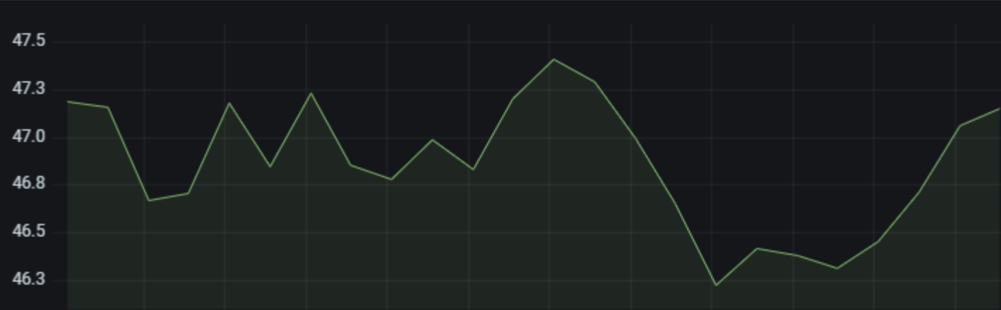

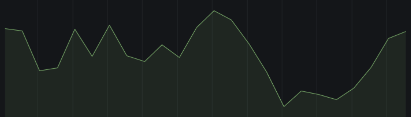

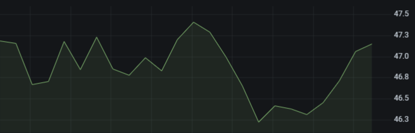

Select the placement of the Y-axis.
Auto
Grafana automatically assigns Y-axis to the series. When there are two or more series with different units, then Grafana assigns the left axis to the first unit and right to the following units.
Left
Display all Y-axes on the left side.
Right
Display all Y-axes on the right side.
Hidden
Hide the Y-axes.

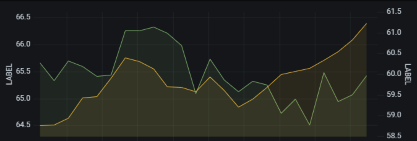

Label
Set a Y-axis text label.
If you have more than one Y-axis, then you can give assign different labels in the Override tab. You can also set the X-axis label using an override.
